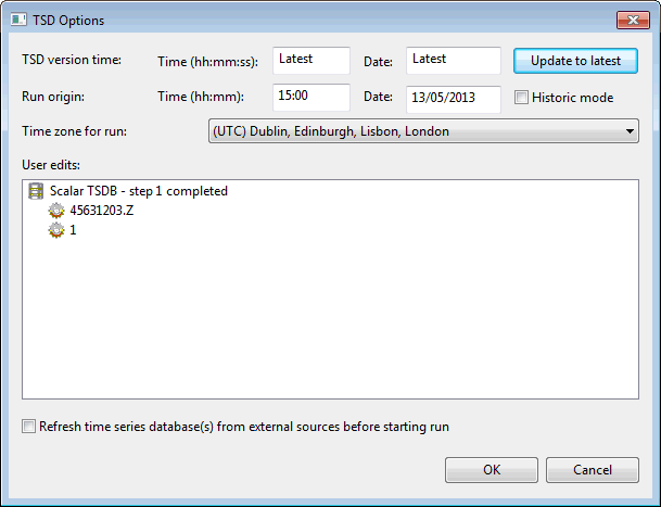

Before performing a run using time series database objects, it is possible to select the TSD user edits to be used. This can be done in the TSD Options dialog, which is accessible from the Schedule Hydraulic Run View.
  1. Click TSD options button in the Schedule Hydraulic Run View.
  2. The TSD Options dialog is displayed.
  3. We will use the same start date and time as the original run, but as we are using TSD data we also need to set the run origin (used to specify the transition between the use of observed and forecast data in a live system). The run origin must lie between the start and finish time of a simulation. As the system is not yet live, it is not important where the run origin is set, but we will set it at 3 hours into the simulation for this simulation (15:00 in Time field and 13/05/2013 in Date field).
    TSDB Options Dialog
  4. Leave all other settings as they are and click OK. The dialog closes.
