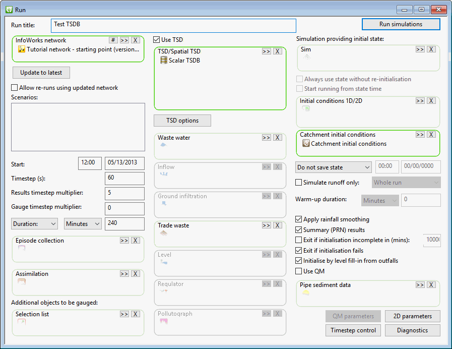

  1. In the Explorer window, drag and drop the Original run, that can be found within the Run group, onto the main window.
    Original Run
  2. The Schedule Hydraulic Run View is displayed. Rename the run title from Original to Test TSDB.
  3. Update the network to the latest by clicking the Update to latest button and check the Use TSD located above the TSD/Spatial TSD droptarget.
    Tip: The other time varying fields (such as Inflow) become greyed out once the Use TSD option is enabled.
  4. Drag the Scalar TSDB object into the TSD/Spatial TSD droptarget. Drop the Catchment Initial conditions object created here into the appropriate field.
  5. Ensure that the Tutorial network - step 1 completed network is dropped into the Network droptarget.

  6. Click Run simulations in the Schedule Hydraulic Run View.
  7. Compare the results of the two simulations to ensure that the results are identical.
