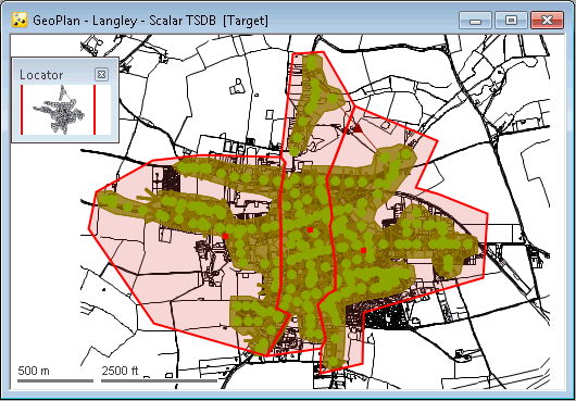

  2. Select the three rainfall TVD connectors (RG1, RG2 and RG3 polygons) in the GeoPlan:
    1. Start by clicking a polygon in the GeoPlan. If the Multiple Selection dialog is displayed, ensure the desired TVD connector is selected in the list. It becomes highlighted in the GeoPlan.
    2. Press the CTRL key and click the second TVD connector. If the Multiple Selection dialog is displayed, ensure the desired TVD connector is selected in the list. It becomes highlighted in the GeoPlan, along with the first TVD connector.
    3. Repeat the previous step for the third connector.
      Selecting the TVD connectors in the GeoPlan

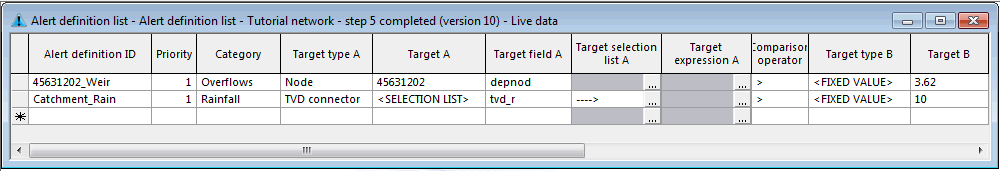

  10. Add an alert definition with the following properties. For an explanation of the various fields please refer to the Alert Definition List topic.
    Property Value
    Alert definition ID
    45631202_Weir
    Priority
    1
    Category
    Overflows
    Target type A
    Node
    Target A
    45631202
    Target field A
    depnod
    Comparison operator
    Target type B
    <FIXED VALUE>
    Target B
    3.62
    Deadband
    0.05
  11. Let us add a second alert, for the rainfall TVD connectors this time. Create a second alert with the following properties:
    Property Value
    Alert definition ID
    Catchment_Rain
    Priority
    1
    Category
    Rainfall
    Target type A
    TVD connector
    Target A
    <SELECTION LIST>
    Target field A
    tvd_r
    Target selection list A
    Select the selection list created earlier (TVD Connectors, see 2)
    Comparison operator
    Target type B
    <FIXED VALUE>
    Target B
    10
    Transform
    Sum over period
    Summation period
    1h

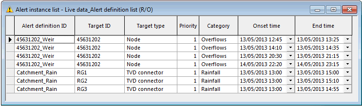

  14. To test whether the ADL is working as it should, open the latest simulation in the GeoPlan and drag the ADL on top of the simulation. Note that a new object, an alert instance list, appears in the tree below the results.
    Alert Instance List
  15. Open the alert instance list and see what alerts have been generated. An example is given below.
    Looking at the generated alerts
