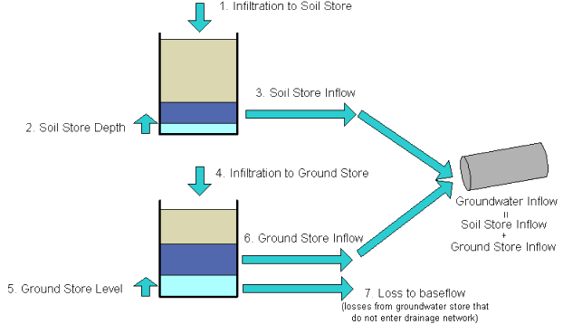

Ground store level |
Level above datum of water in the Ground Store (see diagram below). |
Z |
GRNDSTOR |
Lost to groundwater |
The flow out of the groundwater storage reservoir that provides no contribution (see diagram below). |
Q |
LOSTTOGW |
Infiltration to soil |
Rainfall that infiltrates into the soil. |
Q |
QINFSOIL |
Soil store depth |
Depth of water in the Soil Store (see diagram below). |
Y |
SOILSTOR |
Soil store inflow |
Flow into the drainage node for the subcatchment from Soil Storage (see diagram below). |
Q |
QSOIL |
Ground store inflow |
Flow into the drainage node for the subcatchment from Ground Water Storage (see diagram below). |
Q |
QGROUND |
Infiltration to groundwater |
Percolation flow from the soil into the groundwater. |
Q |
QINFGRND |
Groundwater Inflow |
Flow into the drainage node for the subcatchment from groundwater:
(see diagram below) |
Q |
QINFILT |

Ground Water Infiltration Model
