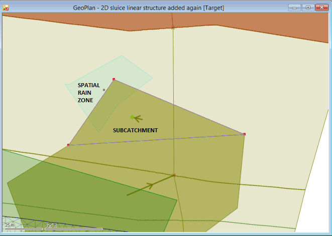

The following example illustrates the effect of inserting vertices into a subcatchment at intersections with a spatial rain zone:
Before:
The subcatchment is composed of three vertices but there are no separate vertices at either of the two intersections with the spatial rain zone

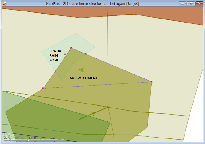

After:
The subcatchment is now composed of five vertices with two of these vertices at the intersections with the spatial rain zone
