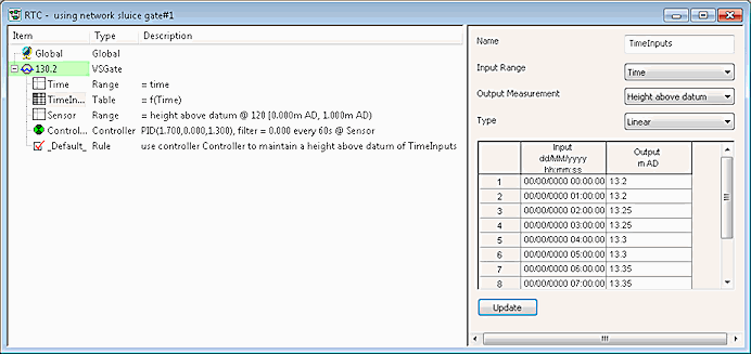

Example
The example below shows the RTC for a sluice gate indirectly controlled by the height above datum at node 120. The required heights for node 120 are specified in Table 'TimeInputs'. A Controller is then used to operate the sluice gate in order to maintain these heights.
A regulator event can be used to replace the output time series in the RTC table 'TimeInputs'.
  1. Create a regulator event in the tree
  2. In the profile properties dialog of the event, specify a Profile type of Indirect and reference the table 'TimeInputs' by entering a Reference of TimeInputs.
  3. Create a new run and drop the regulator event into the Schedule Hydraulic Run View.
  4. Run the simulation
The time series in the regulator event will replace the time series in the RTC table, at the places where the regulator subevent times overlap the table times.
Component
Parameters
Effect
RANGE
'Time'
Range type: T - Time
Location node:
Minimum:
Maximum:
TRUE if height above datum is between - / + infinity
TABLE
'TimeInputs'
Measurement: Height above datum
Input Range: Time
Type: Linear
Input/Output grid: Time vs Height above datum
Relationship between range type defined in RANGE 'Time' and Height above datum (at node 120)
RANGE
'Sensor'
Range type: Height above datum
Location Definition: 120
Minimum: 0.0 mAD
Maximum: 1.0 mAD
TRUE if Height above datum is greater than or equal to 0.0 mAD and less than or equal to 1.0 mAD
CONTROLLER
'Controller'
Type: PID
Measurement: 60
Sensor: Sensor
Rule type: OFF
Measurement interval of 60s
Measurement range used to provide input signal to PID controller defined by RANGE 'Sensor'
RULE
'_Default_'
Condition: _Default_Rule type: CTRL
Controller: Controller
Setpoint type: Variable (TimeInputs)
Operate sluice gate in order to maintain heights as defined in TABLE 'TimeInputs'
