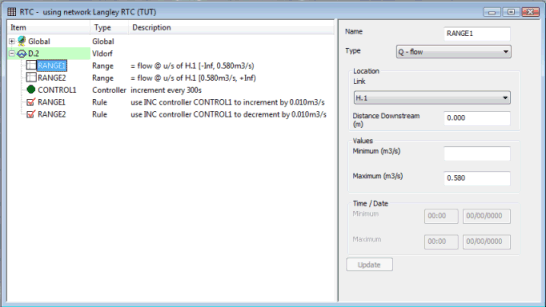

RANGE 1 |
Range type: Q - flowLocation link: H.1Minimum: Maximum: 0.580 m3/s |
TRUE if flow in conduit H.1 is less than 0.580 m3/s |
RANGE 2 |
Range type: Q - flowLocation link: H.1Minimum: 0.580 m3/sMaximum: |
TRUE if flow in conduit H.1 is more than or equal to 0.580 m3/s |

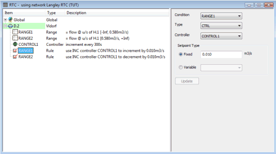

RULE 1
Condition: RANGE 1Rule type: CTRL Controller: CONTROLLER 1 Setpoint: FIXED 0.010 m3/s |
Increment REGULATOR by 0.01 m3/s if RANGE 1 is TRUE |

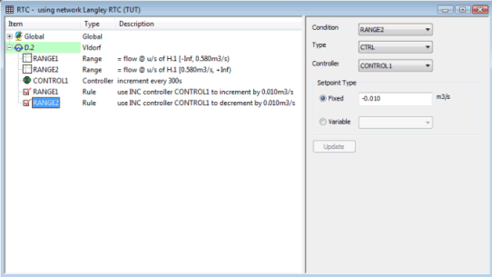

RULE 2 |
Condition: RANGE 2Rule type: CTRL Controller: CONTROLLER 1 Setpoint: FIXED -0.010 m3/s |
Decrement REGULATOR by 0.01 m3/s if RANGE 2 is TRUE |
