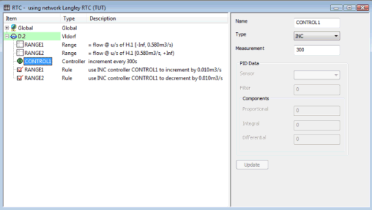

The Controller pane contains the following fields:
Name |
A label that identifies a controller |
Type |
The type of logic to be used to control the regulator:
Measurement Interval |
The interval in seconds between two successive measurements for the controller. The value must be greater than zero; otherwise, the controller will be ignored. The interval must be a multiple of the run timestep for the controller to function properly. |
Sensor |
Only applicable to PID controllers. A measurement range that is used to provide the input signal to a PID controller. The controller will be ignored if the sensor does not point to a valid range or the measurement range is not greater than zero. Only range types of Q, V, Y and Z can be used as the sensor for a controller. |
Filter Coefficient |
Only applicable to PID controllers. A filter can be used to smooth the value sent to the controller by using a weighted average of the current and previous measurements: the larger the value the more the previous measurement contributes. |
Proportional |
Only applicable to PID controllers. The Proportional Coefficient. (See PID Controllers for more information.) |
Integral |
Only applicable to PID controllers. The Integral Coefficient. (See PID Controllers for more information.) |
Differential |
Only applicable to PID controllers. The Differential Coefficient. (See PID Controllers for more information.) |
| Target range | Only applicable to FUZZY and CENTAUR. The name of the range that provides the level at the target node. |
| Gate range | Only applicable to FUZZY and CENTAUR. The name of the range that provides the level at the gate. |
| Target max | Only applicable to FUZZY and CENTAUR. The maximum level at the target node which cannot be exceeded. |
| Gate max | Only applicable to FUZZY and CENTAUR. The maximum level at gate which cannot be exceeded. |
| Target change max | Only applicable to FUZZY and CENTAUR. The maximum change acceptable at the target level. The default value is 0.01 m/s. |
| Gate change max | Only applicable to FUZZY and CENTAUR. The maximum change acceptable at the gate level. The default value is 0.01 m/s. |
| Min output | Only applicable to FUZZY and CENTAUR. The minimum percentage output. This must be less than the Max output. |
| Max output | Only applicable to FUZZY and CENTAUR. The maximum percentage output. This must be greater than the Min output. |
