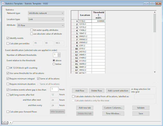

Statistics templates are used to specify the locations and attributes for which statistical summary data is to be produced. The summary data is displayed in Statistical Reports.
To add a new statistics template, right-click on a
Model Group, and select either New
InfoWorks
Statistics template or New
SWMM
Statistics template from the popup menu.
Existing statistics templates can be opened by right-clicking on the template and selecting Open. Note that a statistics template cannot be edited or deleted after it has been used to generate statistics.
For each combination of Location type and Attribute, you can specify whether to report on events and/or percentiles. Up to three percentiles and up to three event thresholds may be defined. There are a number of rules which may be applied when reporting on events (see Event Identification Section below for more details). Selected locations are displayed in a grid.
In addition, a period of time (time window) or a set of regularly recurring time windows may be specified via the Time Windows Dialog. Data used to derive statistics will be restricted to those results which fall within the specified time window.
The items which comprise the statistics template are described in the following sections:

The Event Identification Section is used to define the rules to be used when calculating Exceedance Statistics. The rules are applied in order.
As the most common use of the statistical reports will be for analysing outfall spills, the default values in the template are applicable to standard outfall spills.

The statistics template grid displays the objects to be reported on in the Statistical Reports. The grid can be populated in three ways:
For InfoWorks networks, it is recommended that links which are selected for analysis should be modelled with a gauged timestep as opposed to a results timestep (see the Hydraulic Run View). This will improve the accuracy of the results.
The columns displayed in the grid will vary depending on the Event Identification rules selected.
