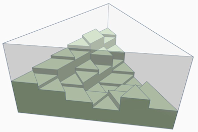

The 2D elements are divided into subgrid triangles and the ground level of each triangle is sampled from the ground model. A volume/level table is created to represent the storage capacity of the 2D element based on the sampled ground levels and area of each triangle. The interfaces between subgrid 2D elements are also divided as part of the triangulation process. The ground level of each subgrid face is also sampled and averaged from the ground model. These composite interface profiles are solved step-wise to obtain a compound mass and momentum flux, which results in a highly accurate representation of topographic barriers between 2D elements.

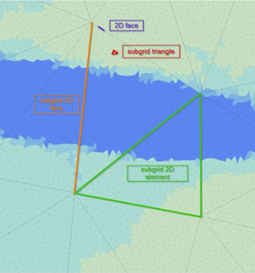

An example of how a subgrid 2D element is represented in the software is shown in Figure 1 while Figure 2 shows the GeoPlan view of a subgrid 2D element, subgrid 2D face, subgrid triangle and 2D face.
Figure 1 - 3D view of a subgrid 2D element with its inner subgrid triangles
Figure 2 - GeoPlan view of a subgrid 2D element, subgrid 2D face, subgrid triangle and 2D face

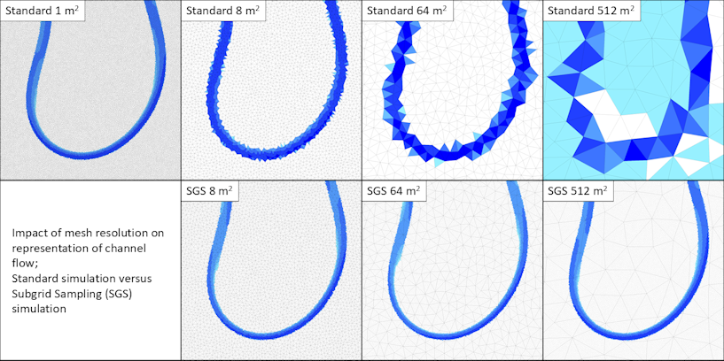

The impact of using Subgrid Sampling to enhance the topographic representation of flow in a channel is shown in Figure 3. The images at the top show the results on a channel for several mesh resolutions using the standard 2D engine. The quality of the results degrade significantly as the mesh resolution coarsens. The bottom show the results obtained using the Subgrid Sampling method in the same channel. The quality of the results after coarsening the mesh resolution is not affected and the engine performance is significantly improved.
Figure 3 - Impact of Subgrid Sampling

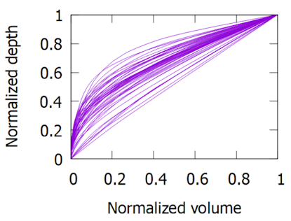

Figure 4 shows the normalised volume/level tables for 50 subgrid 2D elements. Each line in the graph represents the normalised volume level table for a single subgrid 2D element. The volume is normalised between 0 and the maximum volume in the table, and the depth is normalised between 0 and the maximum depth in the table. As opposed to the standard 2D solver, in which each 2D element is represented by a flat surface and the volume level relation is described by a linear relationship, in a subgrid 2D element the volume/level relationship is represented by a discretized curve. The 2D solver performs linear interpolations look ups in the volume/level tables to estimate water levels at subgrid 2D elements.
Figure 4 - Normalised volume/level tables

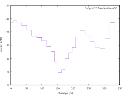

Subgrid 2D face ground levels are calculated as an average of sampling points along the face. As in the subgrid triangle ground level sampling, the number of sampling points is a function of the subgrid triangle size and the ground model. The minimum number of subgrid sampling points for each of the 2D faces in a subgrid 2D face is 2 points, coincident with subgrid triangle vertices. The maximum number of sampling points is 9, which correspond to the sub triangles vertices generated in the recursive subdivision of subgrid triangles. These subgrid 2D face ground levels are included in the model to represent topographic barriers, as opposed to the standard 2D solver where the topography is defined by the element ground levels. An example of a subgrid 2D face is shown in Figure 5, where each step corresponds to a 2D face, whose ground level is sampled from the ground model using a minimum of 2 and a maximum of 9 points as described previously.
Figure 5 - Cross-section view of a Subgrid 2D face

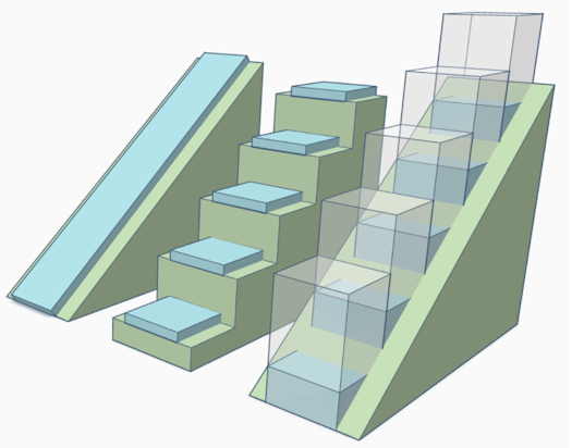

Wave propagation speed
The wave propagation speed generated by the Subgrid Sampling method may be faster than expected. This can become relevant in areas with significant ground slope with shallow flows and is a result of using the volume/level table to characterise the storage capacity of each 2D element.
Figure 8 shows how the water surface is represented in the model in a flat sloping surface. The image on the left shows the real topography and water surface, the middle image represents the standard 2D model in which each 2D element is represented as a flat surface, while the image on the right represents the model used in the Subgrid Sampling method. Each subgrid 2D element is not a flat surface, its storage capacity is characterised by a volume/level table. The water ponds at the bottom of each subgrid 2D element as it travels down the slope. This may result in higher wave speeds than expected.
Figure 8 - Terrain representations
