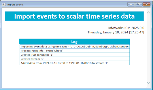

  6. When finished, click OK. The dialog closes and a report is displayed, listing the results of the import:
  7. Import events report
  8. Close the report.
