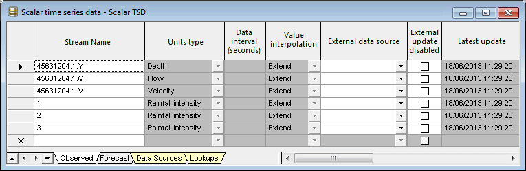

Scalar TSD
An example of a configured scalar TSD

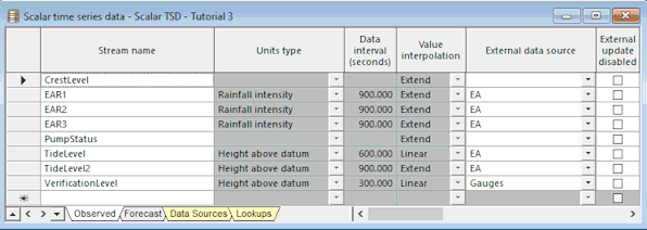

The Observed and Forecast pages contain information about observed and forecast streams respectively. The Data Sources page contains details of the corresponding external sources while the Lookups page is used to map alphanumeric text, in the imported time varying data, to numerical values which are recognised by InfoWorks ICM.
