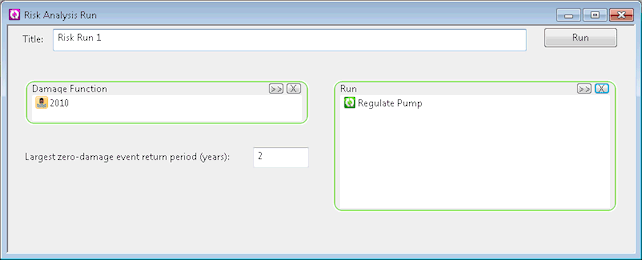

The Risk Analysis Run View schedules a risk analysis simulation. The view is displayed when a new risk analysis run is created (by right-clicking on a model group and selecting New InfoWorksRisk analysis run) or when an existing run is opened (by right-clicking on a risk analysis run and selecting Open).

Run parameter Description
Title
The name of the run.
If the entered title already exists, exclamation marks (!) will be appended to the run name until a unique name is created.
Run
Displays the Schedule Job(s) dialog so you can specify the criteria for running the simulations. The simulations are run according to the specified schedule.
The Run button is disabled if there is missing information in the view.
Note: Risk analysis simulations, for cloud databases, are only run on-premise on your computer. They are not run in the cloud.
Damage Function
The Damage Function to be used in this run. You can select it by:
  • Dragging and dropping a damage function from the Explorer Window tree
  • Clicking Browse (), selecting a damage function from the displayed tree and clicking OK.
Run
The hydraulic Run to be used in this risk analysis run.
Multiple runs may be selected. To be used in a risk analysis run, all selected runs must use the same set of scenarios in the same version of the same network. The network must have at least one Damage Receptor in at least one of the scenarios. All simulations must be complete.
You can select runs by:
  • Dragging and dropping a run from the Explorer Window tree
  • Clicking Browse (), selecting a run from the displayed tree and clicking OK
Largest zero-damage event return period (years)
Largest return period event for which no damage will occur.
May be any non-negative value, including zero.
See Risk Analysis Runs for details about using this dialog.
