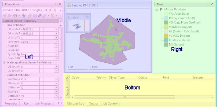

InfoWorks ICM Main Window is the large section that can be found in the
InfoWorks ICM interface between the toolbars and the status bar. It is used for displaying other, subsidiary
windows or views, and is divided into the following parts:
- Left - The default location for the following windows:
- Explorer Window - displays the data in the current database in a hierarchical tree view.
- Object Properties Window
- displays the
Property Sheet for a selected network object. Property Sheets provide a way of looking at all the data for a single network object in a structured and customisable way.
- Thematic Key Window - displays the GeoPlan Window symbols and current themes for the open GeoPlans in a tree view.
- Job Progress Window - displays the status of the job currently being executed.
- Middle - The default location for the following windows:
- GeoPlan Window - displays a selected
network. This window is opened by dragging the icon for a network from the
Explorer Window onto the main window background.
- 3d Network View - provides a view of the ground surface of an
InfoWorks network that has a
ground model loaded on its GeoPlan View.
- 3D Manhole View - displays a 3D animation of a selected manhole and connecting
links.
- Network Object Grid Windows
- spreadsheet-style Grid Windows listing objects present in the network.
- Bottom - The default location for the following windows:
- Right - The default location for the following windows:
Example of the Main Window workspace
Example of layout in
InfoWorks ICM
