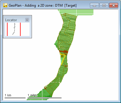

  3. Drag the Adding a 2D zone network onto the main window.
  4. Drag the DTM ground model imported in the earlier exercise onto the main window.
    Starting point of this tutorial

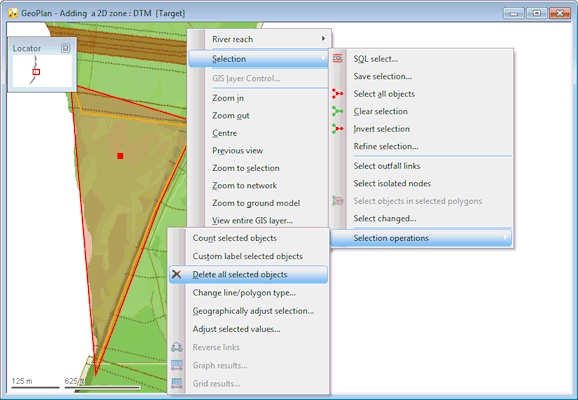

  5. The new 2D zone will replace the 1D storage area added in the first tutorial. So, the first step is to remove the 1D storage node and its associated storage area. Select both items (use CTRL+Click to select multiple items) and then right click on the GeoPlan and choose SelectionSelection operationsDelete all selected objects from the context menu.
  6. Delete storage node and storage area

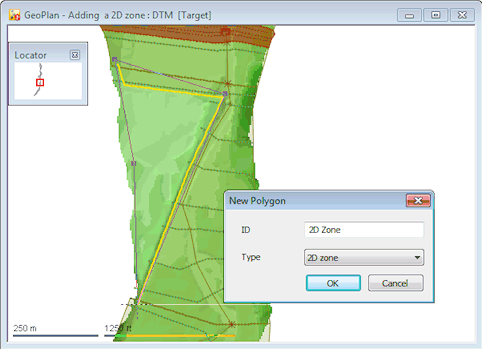

  9. Draw in a new polygon which encompasses the bank line and the reach section ends. When prompted, set the ID as 2D Zone. Set the polygon Type to 2D Zone as well. Note that the 2D zone must have ground model data underneath its entire area. If any area of the 2D zone falls outside the ground model boundary, an error message will be flagged up during the meshing process.
  10. Draw a new polygon

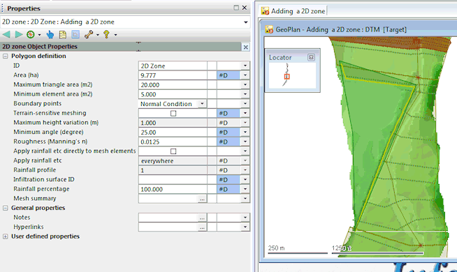

  11. Using the properties tool , select the 2D zone and set the various parameters required. In particular set:
    1. Maximum triangle area to 20.0 m2
    2. Minimum element area to 5.0 m2
    3. Boundary points to Normal Condition
    All other items can be left at their default settings.
    Set 2D zone properties

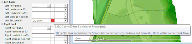

  12. With the 2D zone created, the next task is to join the 2D zone to the neighbouring river reach via the left bank. This is an automated process. Use the Select tool , select the reach and then choose ModelRiver reachBuild bank connections.
    The properties of the River Reach will report that a connection has been made between the reach and the 2D zone, but that, at the moment, there is no hydraulic overlap between the zone and the bank. This would lead to a situation where there would be no overbank flow. Creating a Mesh within the 2D zone will resolve this problem.

At the moment there is no hydraulic overlap between the zone and the bank. This would lead to a situation where there would be no overbank flow. Creating a mesh within the 2D zone will resolve the problem.
