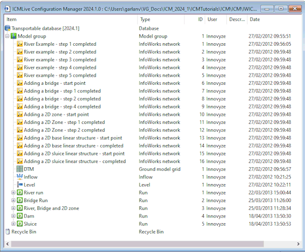

- An
Explorer window opens with the contents of the transportable database.
- The tutorial data is in the Model group. Click on the
button adjacent to the Model group database item to expand its content:
Each network (
) is a copy of the example data as it should appear at the start of each stage of a tutorial.

The transportable database also contains the following database objects:
- The
DTM (
) Ground Model (grid) imported at
step 1 of the River Tutorial.
- The
Inflow (
) and
Level (
) hydrographs created at
step 5 of the River Tutorial.
- The
River Run run, with the
DWF simulation which are created at
- The
Bridge Run run, with the
step 6 of the Bridge Tutorial
- The
River, Bridge and 2D zone run, with the
step 3 of the 2D zone Tutorial
- The
Dam run, with the
DWF simulation which are created in the
Base Linear Structure Tutorial
- The
Sluice run, with the
2D Sluice Linear StructureTutorial

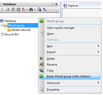

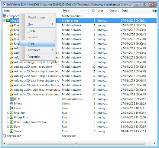

- Right-click on the top level of data you want to copy. For example, you can choose a whole model group (Model group group in our case) or any item in a model group (such as a network, a hydrograph or a simulation). Select
Copy from the popup menu.
- In the Explorer view for the database to be copied to (your database), right-click on the item that is to contain the copied data and select
Paste: nameofitem (with children) from the popup menu.
