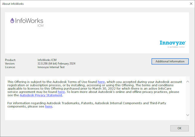

An example of the About InfoWorks box when using InfoWorks ICM with an Innovyze licence:

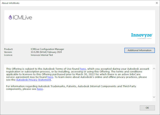

An example of the About InfoWorks box when using ICMLive Configuration Manager with an Innovyze licence:

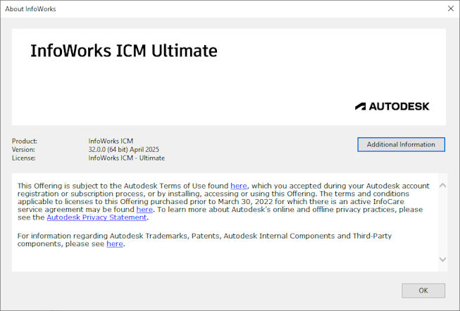

An example of the About InfoWorks box when using InfoWorks ICM Ultimate with an Autodesk Ultimate licence:

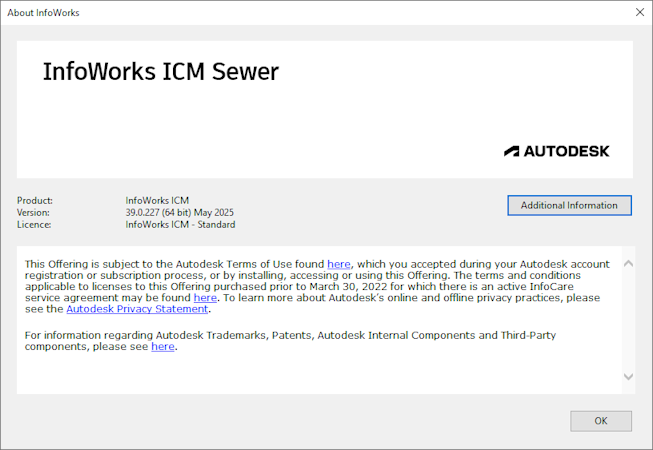

An example of the About InfoWorks box when using InfoWorks ICM Sewer with an Autodesk Standard licence:

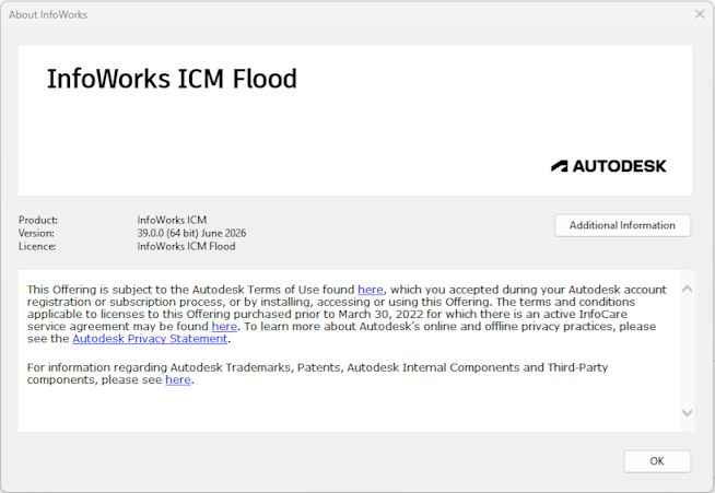

An example of the About InfoWorks box when using InfoWorks ICM Flood with an Autodesk Flood licence:

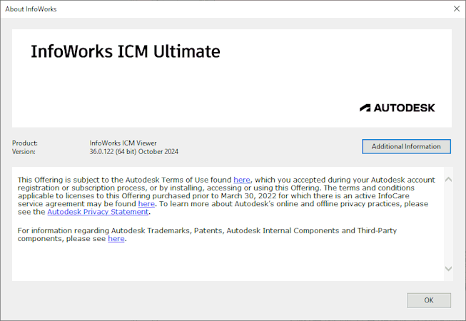

An example of the About InfoWorks box when using Autodesk InfoWorks ICM Viewer:
