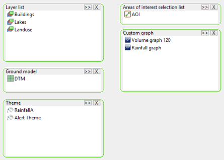

Drop Target Description
Layer list
A droptarget for one or more layer lists.
The first layer list in this droptarget is the one that will be used by default on the network page when the ICMLive Operator Client is opened.
Subsequent layer lists will be available from the Display Window of the ICMLive Operator Client.
Ground model
A droptarget for the Ground model to be displayed in the ICMLive Operator Client.
Theme
A droptarget for one or more GeoPlan themes which will typically contain one or more alerts themes.
The first theme in this droptarget is the one that will be used by default on the network page when the ICMLive Operator Client is opened. Subsequent themes will be available from the Display Window of the ICMLive Operator Client.
If exporting result maps as images, it is highly recommended to specify a theme here as it will be visible in the exported images.
Areas of interest selection list
A droptarget for a single selection list of polygon objects. This selection list contains one or more user-defined areas of interest. If no selection list is selected, InfoWorks ICM automatically generates a bounding polygon from network extents and will use this system default polygon as area of interest. The areas of interest are displayed on the Overview Page of the ICMLive Operator Client and can be themed according to any alerts which may be present in the latest simulation.
Custom graph
A droptraget for one or more Custom Graphs. The custom graphs will be made available for display in the ICMLive Operator Client.
Note: Only Custom Graphs using the Object per page or Simulation per page report style can be used for display in the ICMLive Operator Client.
