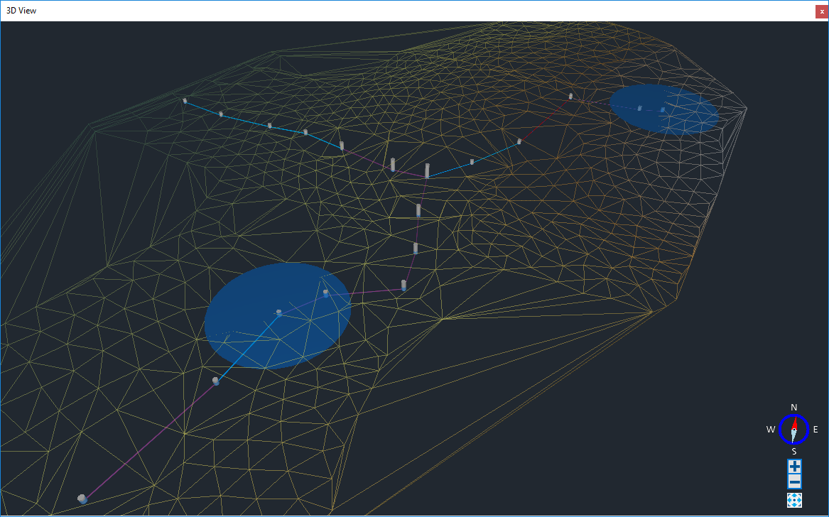

The 3D window displays the locations and dimensions of Stormwater Controls (SWCs), Junctions, Connections, Surface Data, and Overland Flows in three dimensions.
Special Cases
Notional Connections are displayed simply as a line between the exceedance / cover elevation of the connected junctions / SWCs.
Simple Junctions are displayed as a translucent sphere. The size and height of this sphere is determined by the incoming and outgoing connections.
Bypass Connections are displayed identically to other connections in 3D, unlike on Plan.
Inlets and Outlets are not displayed in 3D.
Underdrains are not displayed in 3D on SWCs with custom outlines.
Stormwater Controls that contain multiple smaller structures (Cellular Storage, Chambers, Dry Well) are rendered as cylinders, cuboids or prisms, rather than as a collection of smaller structures, if the position of each smaller structure cannot be determined.

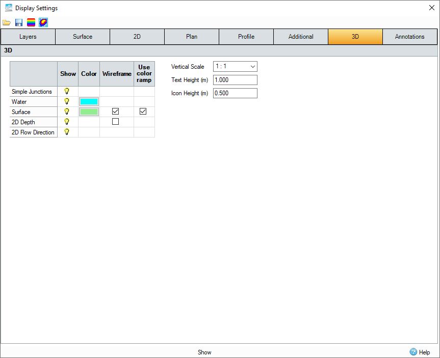

Settings

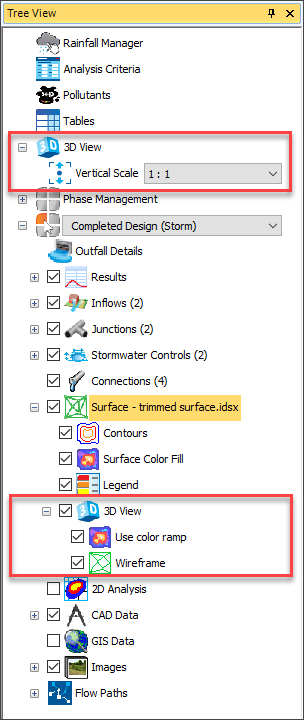

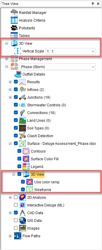

Settings specific to 3D are available under 3D sections in both the Tree View and Display Settings. There is a 3D node in the tree view underneath the surface node, which can be used to quickly update 3D surface settings.
3D Settings on Tree View
3D Settings on Display Settings
