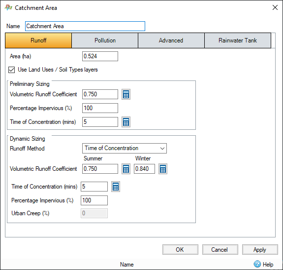

Area
An area can be entered directly or calculated automatically from the polygon drawn on the Plan.
Color
Each catchment can be given its own custom display color.
Click the Color button to open the color picker and choose a color for the catchment. The chosen color is used to draw the catchment's area fill, outline, and icon on the Plan.
If no custom color is chosen, the catchment uses the global inflow color set in Display Settings.
Use Land Uses / Soil Types layers
Use the loaded Land Uses and Soil Types to calculate SCS Curve Number, PIMP, and CV from subcatchments.
InfoDrainage will ask you if you want to automatically override all existing values, even if manually edited, with those derived from Land Use Data. This behavior can be changed in Preferences.
Preliminary Sizing
The Area, Volumetric Runoff Coefficient, Percent Impervious and Time of Concentration values shown in the preliminary Sizing tab will be used for initial sizing of pipes and stormwater controls using Rational Method style calculations.
If these values are not entered here, the default values or the values from the current dynamic sizing runoff method will be used.
When the Use Land Uses/Soil Types layers box is checked, the Preliminary Sizing Percentage Impervious and Volumetric Runoff Coefficient are calculated from weighted averages of Land Uses.
Volumetric Runoff Coefficients
Used to factor the runoff when the Time Area Diagram, Time of Concentration or Green Roof Runoff Methods are selected.
If a UK Rainfall pattern ( FSR Rainfall /  FEH Rainfall) is selected in the Analysis Criteria, values can instead be specified seasonally. The CVs specified will be used for the Summer and Winter storm analysis, if that type of storm is enabled in the Select Rainfall section within the Analysis Criteria.
When the Use Land Uses/Soil Types layers box is unchecked, the Runoff Coefficient Calculator can be used to calculate for the Volumetric Runoff Coefficient from Land Use and Overland Slope.
When the Use Land Uses/Soil Types layers box is checked, the Volumetric Runoff Coefficient is calculated from weighted averages of Land Uses.
