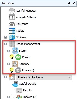

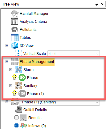

The Phase Management option on the Tree view provides options for adding, duplicating, deleting, and renaming phases as well as the ability to decide if they should be analyzed or not.
The Phase Management option appears in the Tree view below the Design level options and just before the Phase Selector. This provides a quick view on the available phases together with an image to indicate if they are being analyzed or not. Expanding the node will show you the list of available phases, which are grouped by phase type (either Storm phase and Sanitary phase).
Including in Analysis
A phase can be included in the analysis by clicking the or not  icons. To keep analysis times down, it is recommended that you turn off any phases or scenarios you are not currently interested in. They can be turned back on later.

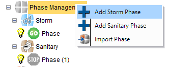

Creating a Phase
Right-clicking the Phase Management will display a menu that provides the Add Storm Phase or Add Sanitary Phase option. Selecting this option will create a new, empty phase and will select it on the Phase Selector ready for editing.
The Import Phase option allows you to import a phase from an external *.iddx file into the current model.

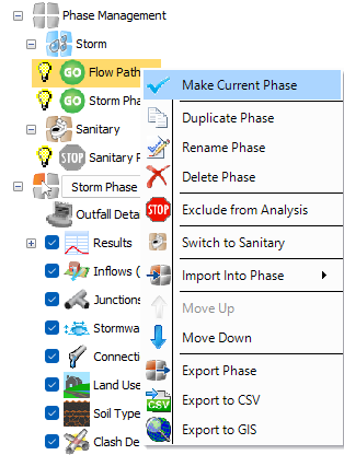

Right-clicking an individual phase shown under the Phase Management will display a menu that provides the following options:
Duplicating a Phase
Selecting this option will create a duplicate of the selected phase and will select it on the Phase Selector ready for editing.

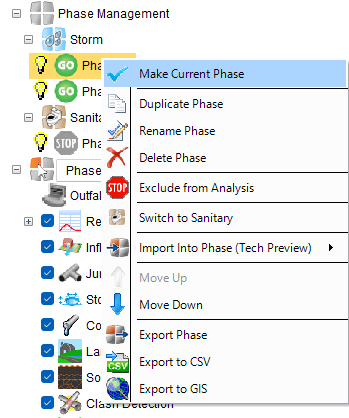

Making a Phase current
Selecting this option will make the selected phase current in the same way as a selecting a phase on the Phase Selector.

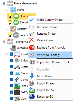

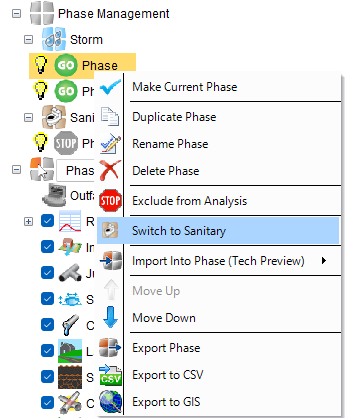

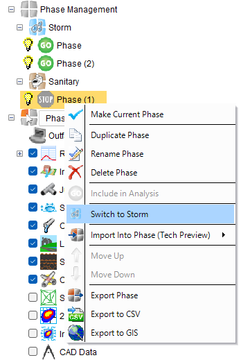

Switching Phase type
It is possible to switch the type of the phase. Right-clicking a Storm phase would display the option Switch to Sanitary.

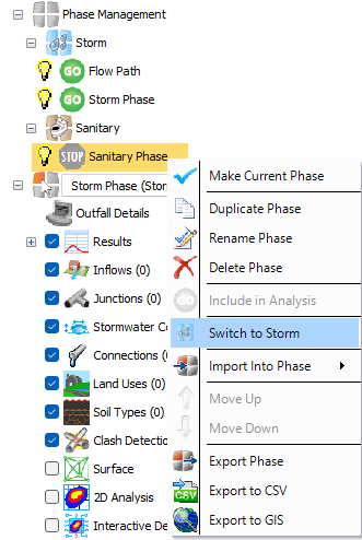

Right-clicking a Sanitary phase would display the option Switch to Storm.

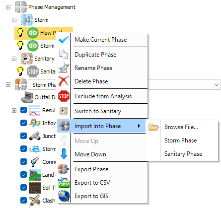

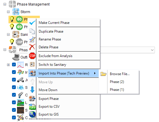

Import Into Phase
This option allows you to merge drainage network data from a source phase (either from the same model file or an external *.iddx file) into an existing target phase.
See Import Into Phase for more information.

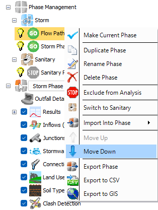

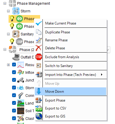

Adjusting Phase order
It is possible to adjust the order of a phase within the phase list. Selecting Move Up will result in the phase being shown higher up the list, while Move Down will move the phase lower in the list.
