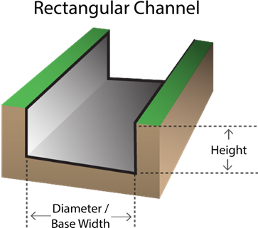

Rectangular Channel is an open channel with a rectangular cross section. The flow routing through a Channel Connection is described in
Analysis of Junctions and Connections.
Parameters to specify:
Length, Slope, either Manning's n or Colebrook-White Roughness, Diameter/Base Width, Height, see
Connections Inputs.
Upstream (US) Cover Elevation, Upstream Invert Elevation, Downstream (DS) Cover Elevation and Downstream Invert Elevation.
Entering a value for Manning's n or Colebrook-White Roughness will clear the value of the other. Manning's n is used by default.
If the Slope or Downstream Invert Elevation are changed by the user, the other variable will be updated to match.
If the Height or Upstream Invert Elevation are changed by the user the other variable will be updated to match.
