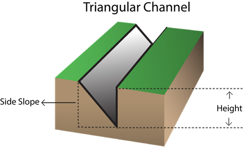

Triangular Channel is an open channel with a triangular cross section where one of the sides is vertical and the other inclined. The flow routing through a Channel Connection is described in

Parameters to specify:
Length, Slope, either Manning's n or Colebrook-White Roughness, Height, Side Slope, see Connections Inputs.
