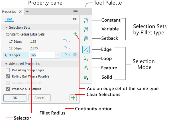

The fillet command makes it easy to apply fillets and rounds of varying radii and conditions as one feature. The property panel provides fillet types, selection modes, and selection sets to achieve a robust filleting operation. For each fillet type you can have multiple selection sets of differing sizes.
For more information about property panel common controls see About Property Panels
The Fillet property panel has a tool palette that is docked to the side. You can drag it away and detach the two if so desired. To reconnect them, click-and-drag one near the other and when the blue edge appears release the mouse button. When the cursor is near the property panel the side where the tool palette will snap is highlighted.
The tool palette controls enable adding multiple fillet sizes and types in one command session:

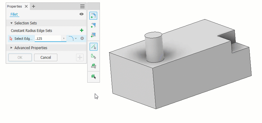

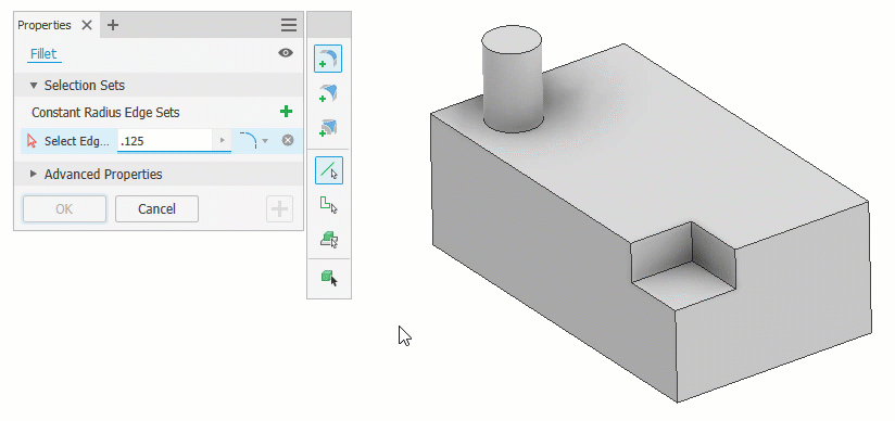

In the property panel, the Constant Radius Edge Set
is immediately active. You can begin selecting edges, modify parameters, or change selection set types before you select edges.
Switch the Select priority to refine how you select:
Edge. Adds or removes (Ctrl+click) single edges.
Loop. Selects or removes the edges of a closed loop on a face.
Feature. Applies a fillet to all edges of the selected feature that do intersect with other features. If used in the assembly environment, only part features can be selected.

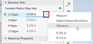

Solid. Selects all edges of a solid body enabling rapid fillet creation. All body edges share the same radius value.Specify the fillet radius using the in-canvas manipulator, in-canvas value editor, or the property panel field. To apply tolerances to the fillet radius, click the arrow in the value field and select Tolerance... then, in the dialog set the desired tolerance type and value.

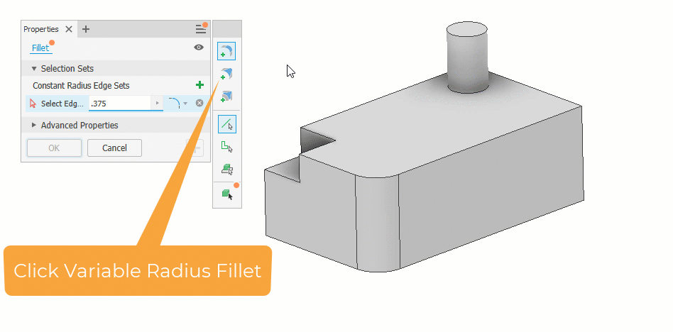

In the property panel tool palette, click the
Variable Radius Fillet. The property panel expands to display the additional input fields.

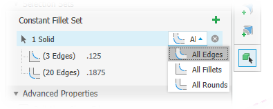

In the Solid selector row, specify how all available edges of the solid body are to be treated:
All Edges (default) - applies both fillets and rounds.
All Fillets - applies only fillets.
All Rounds - applies only rounds.If not automatically selected, select the target solid. The fillets and rounds preview in-canvas, the features preview.
In the property panel, pause the cursor over either selection set to see the participating edges highlighted. Adjust the radius setting as needed. You can clear either selection set if you want to only do rounds or fillets.

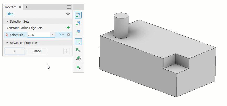

Take advantage of the edge set capability to create multiple fillets in one step.
Use one of the following methods to display the feature property panel:
.In the property panel or with in-canvas manipulators change defining values. To change from edge to face or full round fillets requires deleting and recreating the fillet.

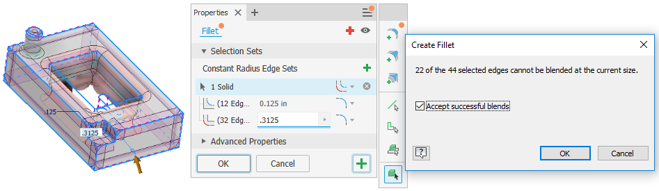

At times a message may display stating that the selected edges cannot be blended. The most common occurrence is when there are too many edges selected, or when one set of edges doesn't work with the specified value.
When such an error occurs, try either of these two ways to resolve the issue:
On rare occasion, there may be conditions where the specified size will not work well and the solutions is to iterate on size reduction until successful.
