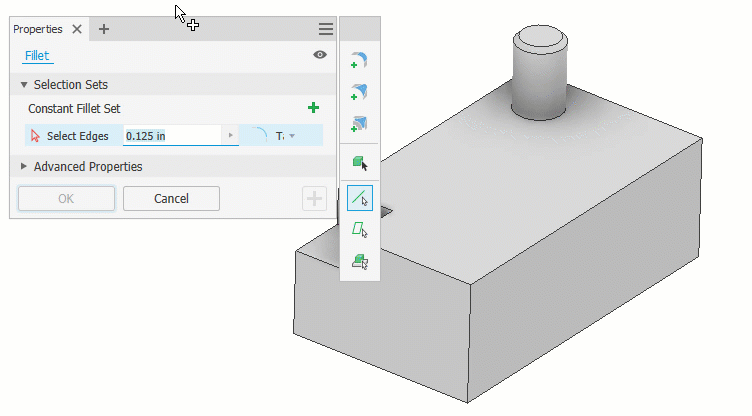

Fillets are placed features that round off or cap interior or exterior corners or features of a part.
You can create edge fillets, which are based on selected edges; face fillets between two adjacent faces or face sets; or full round fillets, which are variable-radius fillets that are tangent to three adjacent faces or face sets.
Although a 2D sketched fillet and a fillet placed feature may appear identical, using the fillet feature has several advantages:
A fillet feature can be edited, suppressed, or deleted independently of the extrusion feature, without returning to the original sketch.
If the remaining edges are to be filleted, you have more control over the corners.
You have more flexibility when performing subsequent operations such as applying face draft.
Some placed feature commands have a graphic manipulator that is used to modify the feature through in-canvas interaction. The manipulators have detents that make it easy to get a commonly used value.
Because other features can affect fillets, add them toward the end of the modeling process. For example:
