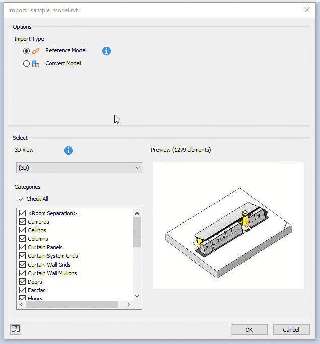

  1. In the Get Started tab Launch panel New Import CAD Files
  2. In the Open dialog, navigate to and select the shared Revit (*.rvt) model you want to import.
    The open dialog displays a thumbnail view and the Revit version used to most recently modify the data.
  3. Click Open. During the open process feedback displays in the lower section of the Import dialog.
    Depending on the Revit file size, opening the file may take several minutes.
  4. In the Import dialog box:
    1. In the Options Import Type section select Reference Model (default).
    2. In the Select section 3D View list, select the 3D view you want to import. The number of Revit elements to be imported is listed above the preview.
    3. For the selected view, an alphabetically sorted Category list displays below the view dropdown. Category list contents are based on the selected 3D view and includes only categories with visible elements. Visibility must be set in the 3D view in Revit. If elements are made visible in a category, that category is included when editing the view.
      Note: More about Categories
      • Category selection is remembered.
      • Excluded categories are not imported regardless of element visibility.
      • If there are no visible elements in an excluded category, the category is dropped from the list of excluded categories. If, later, elements are made visible in that category, the category will appear in the list when editing the view.
      • If the Revit view is edited and element visibility is changed, when Inventor updates the view, elements no longer visible are removed and newly visible elements are imported.
      • Some categories and their elements are not imported because Inventor does make use of them. For example Levels, Cameras, and so on.
    4. Use the Check All option to quickly clear the list so you can check just a few categories to include.
    5. Check the Include linked files box to include or all linked files in the import process. Note that the option is disabled if no linked files are present.
    6. Check the Include linked files box to include or all linked files in the import process. Note that the option is disabled if no linked files are present.
    7. Changing the 3D view resets the categories list. The previous view and selections are not remembered.

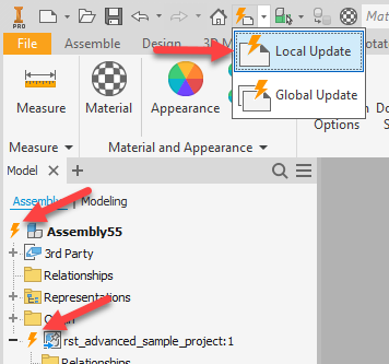

Updating Reference Models
The update notification, lightning bolt next to a browser node, appears when:
When you see the lightning bolt, click the Local Update command to apply all pending changes, both the Revit model and Inventor components. Updates may affect dependencies, such as constraints and adaptive parts.
Note: Updating may be a time-consuming operation. The update should be similar in duration to the original import.

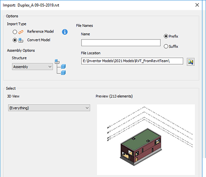

    1. In the Options Import Type section select Convert Model.
    2. Select the Assembly Options for how the converted Revit is structured. Choose between:
      • Assembly - The Revit elements are imported as subassembly and part occurrences under a main assembly. Each Revit element, in general, is an occurrence. In this format, the individual Revit elements are grouped into folders using their Revit "category", "family" and "type".
      • Multi-body part - The Revit elements are imported as bodies under a single Inventor part.
      • Composite part - The Revit elements are imported as surfaces under a single Inventor part.
    3. Optionally, in the File Names section, specify a prefix or suffix for the Inventor models that are created.
    4. Specify or Browse to the File Location. The default file path is the same location as the Revit file.
  5. In the Select section 3D View list, select the 3D view you want to import. The number of Revit elements to be imported is listed above the preview.
  6. Click OK. The converted model is imported with the Z axis as the up direction and as the top level node in the assembly. You can place one or more instances of the Revit model in the Inventor assembly.
Note: Converted files are not associated to the source model. To change views you must reimport the Revit model and select the desired view.
The Revit model is imported into an Inventor assembly with the same name as the Revit file.

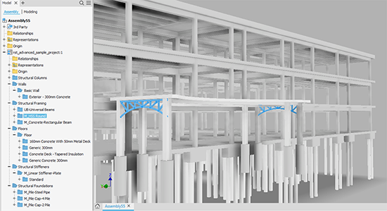

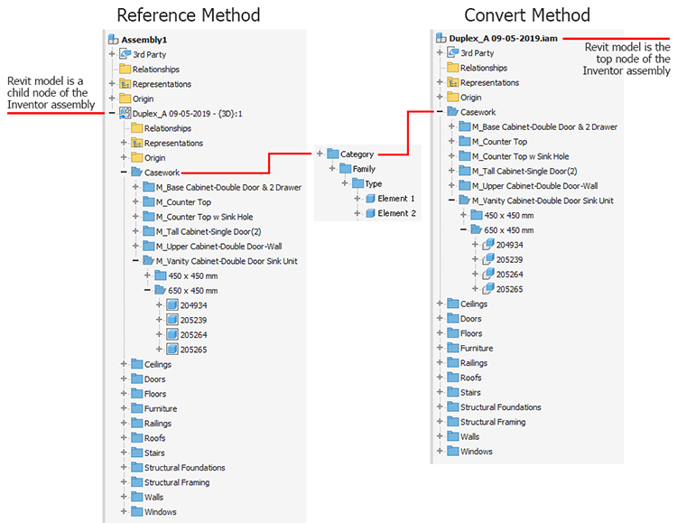

Compare import results in the Model browser
The model browser populates differently based on the method used. This image compares the browser between import modes:
Note: Reference mode uses the Assembly format for the imported file.
