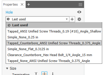

  3. Specify a preset. If there are no presets or the preferred one doesn't exist, continue the process specifying the needed hole parameters.
    Note: When finished specifying the parameters and click OK, a preset named Last Used is created automatically. You can continue to use the preset or save it to a specified name. Tolerance values on hole parameters are saved in the preset.
    Important: If you want to create a preset, and the option is disabled, then, the HoleCmd.preset file is set to Read-only. Navigate to %USERPROFILE%\AppData\Roaming\Autodesk\Inventor xxxx\Presets folder. Right-click the preset file and click Properties. On the General tab, in the Attributes section, deselect Read-only.
