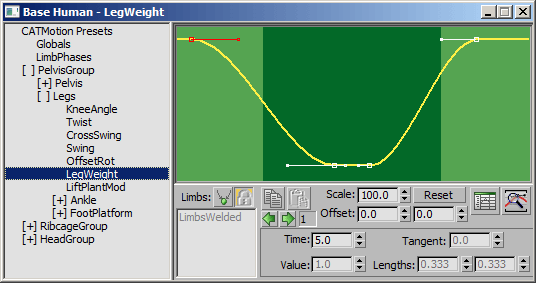

This is a CATMotion controller used in the animation of Legs in 3ds Max CAT.
Other controllers used for CATMotion Limb Animation include CATKneeAngle : FloatController and CATLiftPlantMod : FloatController

 <CATLegWeight>.LimbData (CATLimbData) : maxObject
Contains the LimbData controller object.
 <CATLegWeight>.LiftStartTime : float
Get/set the Lift Start Time value.
 <CATLegWeight>.LiftEndTime : float
Get/set the Lift End Time value.
 <CATLegWeight>.PlantStartTime : float
Get/set the Plant Start Time value.
 <CATLegWeight>.TroughTanLength (PlantEndTime) : float
Get/set the Through Tangent Length value.
