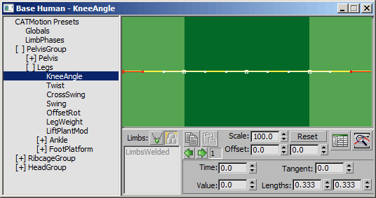

 <CATKneeAngle>.LimbData (CATLimbData) : maxObject
Contains the LimbData controller object.
Lift Knee Angle
 <CATKneeAngle>.LiftValue : float
Get/set the Lift Knee Angle value.
 <CATKneeAngle>.LiftTangent : float
Get/set the Lift Tangent value.
 <CATKneeAngle>.LiftInTanLength (LiftInTanLen) : float
Get/set the Lift In Tangent Length value.
 <CATKneeAngle>.LiftOutTanLength (LiftOutTanLen) : float
Get/set the Lift Out Tangent Length value.
Mid-Lift Knee Angle
 <CATKneeAngle>.MidLiftValue : float
Get/set the Mid-Lift Knee Angle value.
 <CATKneeAngle>.MidLiftTime : float
Get/set the Mid-Lift Knee Angle time.
 <CATKneeAngle>.MidLiftTangent : float
Get/set the Mid-Lift Knee Angle Tangent value.
 <CATKneeAngle>.MidLiftInTanLength (MidLiftInTanLen) : float
Get/set the Mid-Lift Knee Angle In Tangent Length value.
 <CATKneeAngle>.MidLiftOutTanLength (MidLiftOutTanLen) : float
Get/set the Mid-Lift Knee Angle Out Tangent Length value.
Plant Knee Angle
 <CATKneeAngle>.PlantValue : float
Get/set the Plant Knee Angle value.
 <CATKneeAngle>.PlantTangent : float
Get/set the Plant Knee Angle Tangent value.
 <CATKneeAngle>.PlantInTanLength (PlantInTanLen) : float
Get/set the Plant Knee Angle In Tangent Length value.
 <CATKneeAngle>.PlantOutTanLength (PlantOutTanLen) : float
Get/set the Plant Knee Angle Out Tangent Length value.
Mid-Plant Knee Angle
 <CATKneeAngle>.MidPlantValue : float
Get/set the Mid-Plant Knee Angle value.
 <CATKneeAngle>.MidPlantTime : float
Get/set the Mid-Plant Knee Angle time.
 <CATKneeAngle>.MidPlantTangent : float
Get/set the Mid-Plant Knee Angle Tangent value.
 <CATKneeAngle>.MidPlantInTanLength (MidPlantInTanLen) : float
Get/set the Mid-Plant Knee Angle In Tangent Length value.
 <CATKneeAngle>.MidPlantOutTanLength (MidPlantOutTanLen) : float
Get/set the Mid-Plant Knee Angle Out Tangent Length value.
