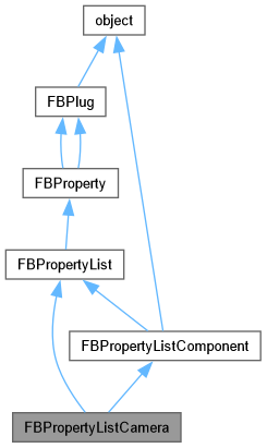

b>PropertyList: Character. More...
#include <pyfbsdk.h>
Public Member Functions | |
| FBPropertyListCamera () | |
Public Member Functions inherited from FBPropertyList | |
These classes are under development and may change dramatically between versions.
