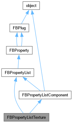

#include <pyfbsdk.h>
Public Member Functions | |
| FBPropertyListTexture () | |
Public Member Functions inherited from FBPropertyList | |
| int | __len__ () |
| Returns the number of elements. | |
| Element | __getitem__ (int pIndex) |
| Returns the ith component Corresponds to python: print l[1]. | |
Public Member Functions inherited from FBProperty | |
| FBProperty () | |
| Constructor. | |
| bool | AllowsLocking () |
| AllowsLocking. | |
| str | AsString (FBDataAsStringFlag pFlag=kFBDataAsStringUI) |
| Get the property value as a string. | |
| str | EnumList (int pIndex) |
| Return the string of an enum value. | |
| FBStringList | GetEnumStringList (bool pCreateIt=False) |
| String list for enum properties. | |
| float | GetMax () |
| GetMax. | |
| float | GetMin () |
| GetMin. | |
| str | GetName () |
| Get the property's name. | |
| bool | GetPropertyFlag (FBFlag pFlag) |
| GetPropertyFlag. | |
| FBFlag | GetPropertyFlags () |
| GetPropertyFlags. | |
| FBType | GetPropertyType () |
| Get the property's type. | |
| str | GetPropertyTypeName () |
| Get the property's type name. | |
| FBProperty | GetReferencedProperty () |
| Get the referenced property, in the case of this property is a reference property (see the IsReferenceProperty() method). | |
| int | GetSubMemberCount () |
| GetSubMemberCount. | |
| bool | HasSomethingLocked () |
| HasSomethingLocked. | |
| bool | IsAnimatable () |
| bool | IsInternal () |
| bool | IsList () |
| Verify if property is of this type. | |
| bool | IsLocked () |
| IsLocked. | |
| bool | IsMaxClamp () |
| Indicate if maximum value clamping will be applied on user input value. | |
| bool | IsMemberLocked (int pIndex) |
| IsMemberLocked. | |
| bool | IsMinClamp () |
| Indicate if minimum value clamping will be applied on user input value. | |
| bool | IsObjectList () |
| Indicate if is an instance of FBPropertyListObject. | |
| bool | IsReadOnly () |
| Is property read-only? | |
| bool | IsReferenceProperty () |
| bool | IsTextureConnectableProperty () |
| bool | IsUserProperty () |
| ModifyPropertyFlag (FBFlag pFlag, bool pValue) | |
| ModifyPropertyFlag. | |
| NotifyEnumStringListChanged () | |
| Notify system that the enum list was modified. | |
| str | OriValueAsString () |
| Get the property original value (before any modification) as string. | |
| SetLocked (bool pLocked) | |
| SetLocked. | |
| SetMax (float pMax, bool pForceMaxClamp=False) | |
| SetMax. | |
| SetMemberLocked (int pIndex, bool pLocked) | |
| SetMemberLocked. | |
| SetMin (float pMin, bool pForceMinClamp=False) | |
| SetMin. | |
| SetName (str pName) | |
| Set the property's name. | |
| bool | SetString (str pString) |
| Set the property value from a string. | |
Public Member Functions inherited from FBPropertyListComponent | |
| int | __len__ () |
| FBComponent | __getitem__ (int pIndex) |
| Returns the ith component Corresponds to python: print v[1]. | |
| __setitem__ (int pIndex, FBComponent pComponentValue) | |
| Sets the ith components Corresponds to python: v[1] = my_component. | |
| bool | __contains__ (FBComponent pComponent) |
| Check if a FCComponent is already in PropertyList Corresponds to python: if object in propertyList: | |
| append (FBComponent pComp) | |
| Append new FBComponent at end of list. | |
| int | count () |
| insert (int pIndex, FBComponent pComp) | |
| Insert a new element in list. | |
| remove (int pIndex) | |
| Remove an element in list. | |
| removeAll () | |
| Remove all elements of list. | |
| FBComponent | pop () |
| Remove last element of list. | |
| FBComponent | pop (int pIndex) |
Additional Inherited Members | |
Public Attributes inherited from FBProperty | |
| str | Name |
| Read Property: The property's name. | |
| object | Data |
| Read Write Property: The property data value. Type of this depends on the subclass of FBProperty (ex: in a FBPropertyInt, Data is of type int). | |
Public Attributes inherited from FBPlug | |
| str | ClassGroupName |
| ClassGroupName of the object. | |
| int | TypeInfo |
| TypeInfo. | |
