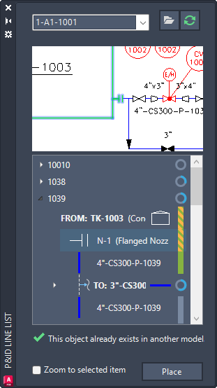

  2. On the ribbon, click Home tab Part Insertion panel P&ID Line List.
  3. In the P&ID Line List window, do the following:
    • In drop-down list, click the P&ID drawing whose lines and components you want to view.
    • In the tree view, expand the Pipe Line Group. Click an equipment.
    • Click Place.
    Note: If a certain nozzle tag exists in the Plant 3D equipment template, all the property values of the nozzles are copied to the corresponding Plant 3D nozzles.
  4. After placing the P&ID equipment, do the following:
    • In the tree view, click a nozzle.
    • Click Place.
