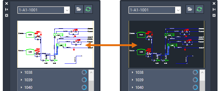

To Customize the P&ID Preview Background
You can customize the background color of the P&ID preview.
In the P&ID Line List window, right-click the P&ID preview.
Select Invert Background Color.
