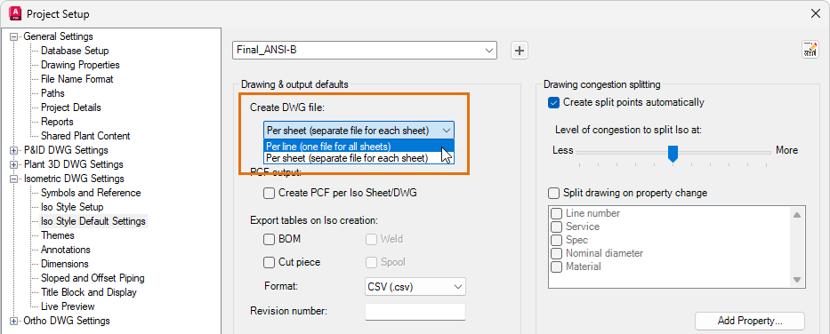

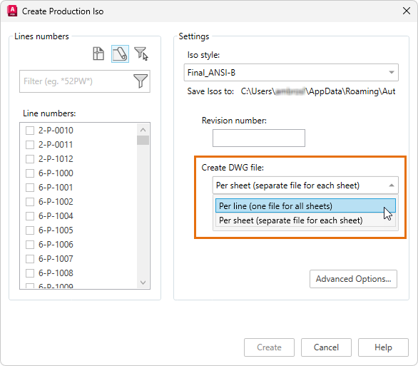

Consolidate Iso Sheets into a Single Drawing

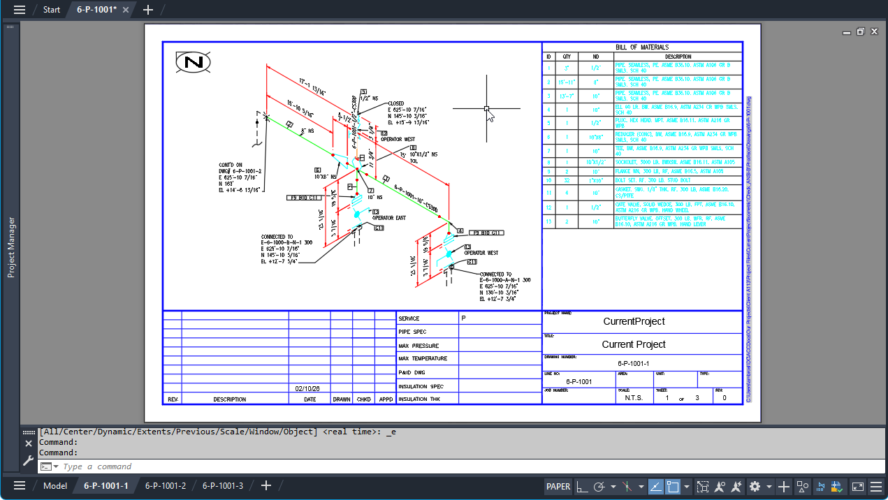

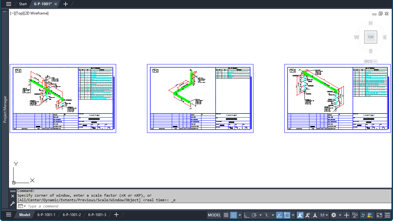

To simplify Iso drawing management, Iso drawings can now be created per line. All Iso sheets for the same line number are generated in a single Iso drawing file. Each Iso sheet is displayed as a separate layout within the drawing, making it easy to switch between layouts and review Iso details.
In previous releases, each Iso sheet was created as a separate drawing file. The new Per Line option allows these sheets to be consolidated into a single file. This option is available in the Create Production Iso, Quick Iso, and PCF to Iso dialog boxes.
The Per Line option is also available under the Iso Style Default Settings node in Project Setup, where the setting can be configured before Iso creation.
Note: Note: For newly created projects, Per Line is set as the default. For existing projects, the default remains Per Sheet, consistent with previous releases.
