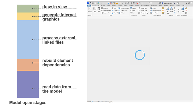

Model Open Stages
Opening a Revit model involves several processing stages before the first view is displayed.
Typical model open stages include:
The amount of time spent in each stage varies depending on model structure, linked content, visibility settings, and overall project complexity. The distribution of time across these stages creates distinct model open performance patterns. Incremental Model Open provides the greatest benefit when most open time is spent reading and processing model data.
