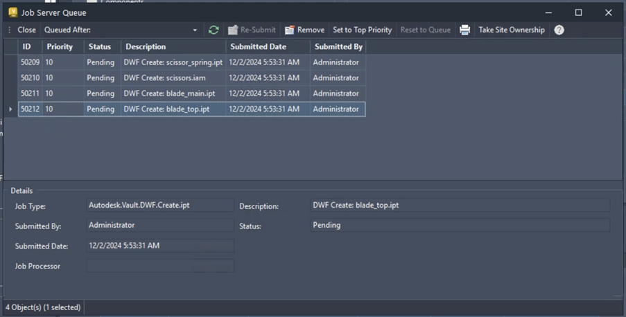

Understand the Job Server Queue Dialog
The Job Server Queue dialog allows you to manage jobs that have been queued for publishing. On this dialog you can manually print jobs, resubmit a suspended job, review individual job details, and customize how job queue information is displayed.

Job Server Queue Details
This table describes the details of the Job Server Queue dialog.
Detail | Description |
Job Type | The type of job that was submitted for processing. Visualization jobs display as Autodesk.Vault.DWF.Create, where is the file extension. |
Submitted By | Displays the name of the user who submitted the job to the queue. |
Submitted Date | Displays the date and time the job was submitted to the queue. |
Job Processor | Displays the name of the computer that has taken the job from the queue for processing. |
Workgroup | Displays the workgroup where the job was created. Not visible by default; add through the column customization menu. See Customize How the Job Server Queue Displays Information and View Workgroup Information in Job Queue. |
Description | Displays more information about the job in the queue. This field will also display the DWF Create: filename. |
Status | Displays whether the job's status is Pending, Processing, or Error. |
Results | Displays information only if the job has an error status. |
