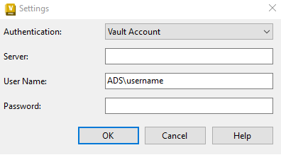

  1. On the workstation where you want jobs to be processed, go to the Windows Start menu and select Autodesk Data Management > Autodesk Job Processor [edition] for Vault.
  2. Click File > Server Credentials.
    Note: If the Job Processor is processing jobs, click File > Pause first.
  3. In the Server Credentials dialog, select the Authentication method:
    • Vault Account — Requires a Vault user name and password.
      Note: If an administrator enforced a password policy and your password does not meet the requirements, change your Vault account password in Vault Client or contact your administrator.
    • Windows Account — Uses Windows Active Directory credentials, which are entered for you.
    • Autodesk Account — Uses Autodesk Account credentials. In the Autodesk - Sign In dialog, enter your e-mail address and password, then click Sign in.
  4. Specify the Server from which you want the Job Processor to connect.
  5. Enter the User Name and Password for the Vault account, if required.
  6. Click OK.
  7. Click File > Resume to connect to the server and begin processing jobs.
