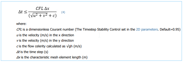

The conservative formulation of the SWE is essential in order to preserve the basic fundamental quantities of mass and momentum. This type of formulation allows the representation of flow discontinuities and changes between gradually and rapidly varied flow. The conservative SWE are discretised using a first-order finite volume explicit scheme. Finite volume schemes use control volumes to represent the area of interest. With finite volume methods the modelling domain is divided into geometric shapes over which the SWE are integrated to give equations in terms of fluxes through the control volume boundaries. The scheme that is used to solve the SWE is based upon the Gudunov numerical scheme, with the numerical fluxes through the boundaries of the control volumes computed using the standard Roe’s approximate Riemann solver. Finite volume methods are generally considered to have a number of advantages in terms of conservativeness, geometric flexibility and conceptual simplicity. As the scheme is an explicit solution it does not require iteration to achieve stability within defined tolerances like the 1D scheme. Instead, for each element, the required timestep is calculated using the Courant-Friedrichs-Lewy condition in order to achieve stability, where the Courant-Friedrichs-Lewy condition is:
