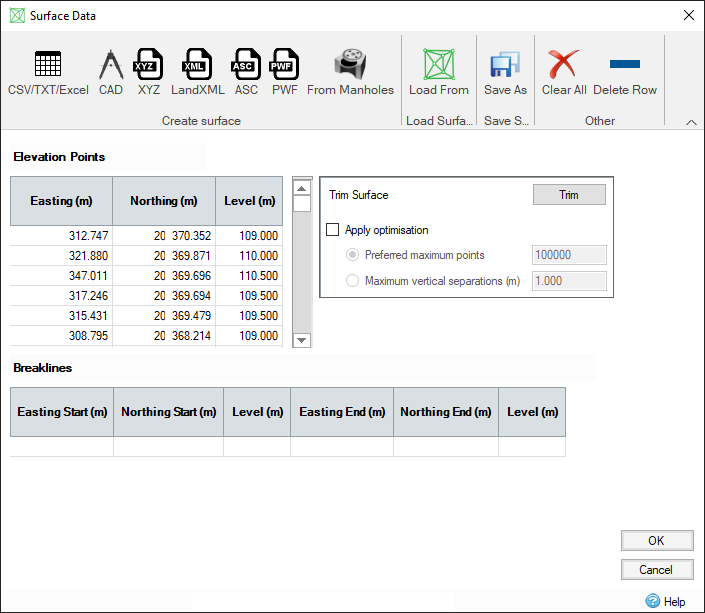

Surface Data allows a ground model to be loaded from file, or entered manually, for use by deluge and for extracting Exceedance Levels automatically for Stormwater Controls.
Data can be entered manually, or copied and pasted, into the data tables if desired. However, in most instances data will be loaded from one of the many accepted file formats, or generated from known levels as shown on the ribbon:
CAD – Allows one or more layers to be loaded from a CAD file as vertices and/or breaklines. A choice of unit is offered in case the file is in another unit to that being used by the software.
Merging CSV/CAD data
Data from multiple CSV/TXT/Excel and/or CAD files can be merged together, rather than replacing the existing information. This allows a complex surface to be created from tiles of LIDAR data, for example, or from layers in different CAD files.
If an existing IDSX file needs to be referenced by a particular phase, you can use the Load Surface > IDSX option. This will replace any data on the form and any existing IDSX links for the current phase.
Once loaded, the data can be viewed and edited within the tables on the form if needed. When OK is clicked the software will perform a triangulation, and save the surface file created to an IDSX file that is then referenced by the current phase. This file can be referenced by several different phases within the design to save disk space, as well as being reused by other designs if needed.
The IDSX file will be named and stored relative to the Design file itself, if it has already been saved to IDDX. If this is not the case, the software will prompt the user for a suitable file name.
It is possible to save the current state of the file to a specific file while editing. This allows control over the file name should this be needed. Click 'Save As' to specify a file name that will then be used to store the surface data, which will then be referenced by the current phase.

Surface Data information can come from a variety of sources, and is often in a very raw format based on a survey. This data may be purchased and supplied for a much larger area than is required, or may contain large flat areas that contain many thousand similar points. The software provides two additional options to help reduce the data overhead, and therefore reduce files sizes and loading times:
Trim TIN
The surface boundary can be defined by using the Trim Surface to remove information that is not necessary by the design.
Optimisation
Optimisation will be applied automatically if the option is ticked when OK is clicked. This will then perform an optimisation of the surface data as outlined below, and will request that the surface data is stored to a file.
As LIDAR data becomes more readily available, it becomes possible to build terrain models with increasing levels of detail. However, more data is not necessarily better, as it may increase file size and degrade application performance without contributing anything to the triangulation.
In the past data sets were thinned by simply removing each second point (for example), or by other methods that were not data-aware. Approaches such as this run the risk of removing crucial points, such as sinks or ridge lines. The TIN Optimizer examines the data set and selects the most important points with regard to maintaining gradient, as this is the single most important consideration for 2D flow analysis. Points are selected based on most significant contribution until either the resulting TIN contains the specified number of points or the vertical separation between the remaining points, which will be discarded, and the resulting TIN surface is within the acceptable tolerance.

The tile size and area can be entered under TIN Area.
TIN points can be optimised using preferred maximum points or maximum vertical separation (m).
Once created, the Surface File will be shown in the Tree View against the Surface node. The set of Surface-related layers are shown below the Surface Node in the Tree. It is possible to adjust the visibility of each layer in the file using the tick box shown next to the label.
It is possible to remove the Surface File reference by right-clicking on the Surface Data node on the Tree View and selecting Clear All.

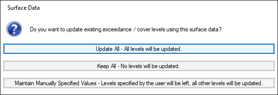

When the Surface Data form is closed, a message box will appear with the following options:
