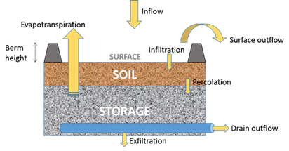

A Stormwater Control can be made of multiple inter-connected layers with different properties. Here is a sketch of the representation of layers within the SWMM5 LID methods:
The Surface layer is used in the SWCs that have a Ponding Area: Bioretention, Pond, Swale. It is also used to represent the storage in the Tank and the Chamber. It is also used to store any flooding in SWCs that do not have a Ponding Area. The Soil layer is used only in the Bioretention. The Storage layer is used in the Bioretention, the Soakaway, the Infiltration Trench, the Porous Paving and the Swale with Trench. |
Connections can be attached to any layer in a SWC, this applies to both incoming connections, either via an Inlet or a direct connection (No Restriction inlet), and outgoing connections, either via an outlet or a direct connection (Free Discharge outlet).
Pollutant removal can be specified in each layer.
A Stormwater Control can be made of up to 3 layers. These layers can exchange water depending on individual inflows, outflows and available capacity.
