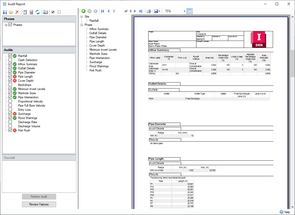

The Audit Report allows you to quickly check properties of the design against criteria, check for errors or test for compliance.
The toolbar in the Print Preview dialog offers a convenient way to modify page setup and printer selection, navigate and view specific output pages, change views and find text within the document.
The Print report icon allows selection of the page size, orientation, and margins.
The Save icon allows exporting of the currently drawn set of reports to a variety of formats:
The Click to open/close document map icon allows to show or hide the document map.
The toolbar in the selection control offers a way to modify fonts and page setting used on the report. It also allows you to save and load the report to an Audit Report File (*.idarx), and to clear the report.
Save – Allows you to save the current report in a *.idarx format.
Open – Allows reports to be loaded from a *.idarx file.
Clear – Allows you to remove the current Audit report.
Header Font – Opens a dialog box to allow changing of font, font style, text size and script.
Select Report Font – Opens a dialog box to allow changing of font, font style, text size and script for the Audit report.
Reset Fonts – Resets both the header and report font back to default.
Edit Page Settings – Opens a dialog box to allow page settings to be changed. This is linked to the Local Page Setting in file print.

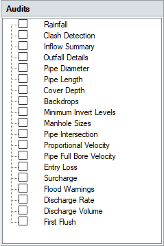

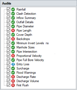

Select all audits – All audits will be selected for auditing in the Audit Selection.
Deselect all audits – All audits will be deselected for auditing in the Audit Selection.
Select which Phases to audit from the list of phases in your model.
The audit selection section allows you to check audits to be included in the audit report. Selecting an audit in the audit selection section will display the details of the audit in the selected audit details section.

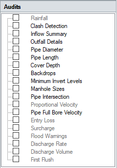

The Audits Selection section when Foul Phase is selected:
When Dry Weather phases are the only phase type selected, the following audits will be disabled as they are incompatible with the phase type:
Additionally Proportional Velocity and Surcharge audits will have the rainfall option disabled.

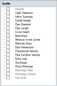

The Audits Selection section when Dry Weather Phase is selected:
The following audits are available:

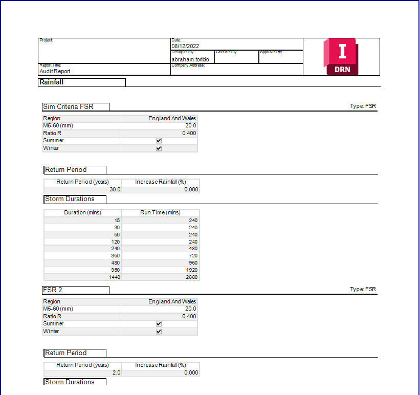

| Audit | Input | Validation | Output |
| Rainfall | No input required. | The site must contain at least one selected rainfall type in the Analysis Criteria. | Table of information on currently selected rainfall types in the analysis criteria, including selected return periods and storm durations. This is similar to the rainfall section in the analysis criteria section seen in print preview. |

The Selected Audit Details section will display any user inputs an audit requires.
Pressing the Perform Audit
button will run the selected audits on the selected phases, and generate a report containing the input details and results of each audit. However, before this happens, validation is run to ensure the report can be generated.
After performing the audit, the audit selection control will display the pass/fail state of the audit. If the audit passes in all selected phases, then the audit will be marked as passing. If the audit fails in a single phase, then it will be marked as failing. If a selected audit has not been run, or data has changed since the previous audit, then it will be marked as needing to be rerun.

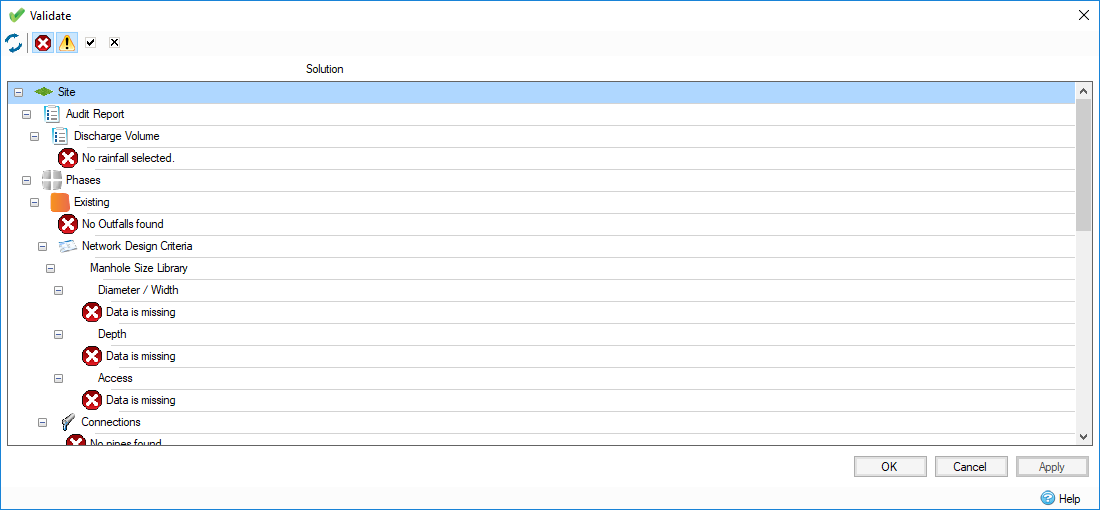

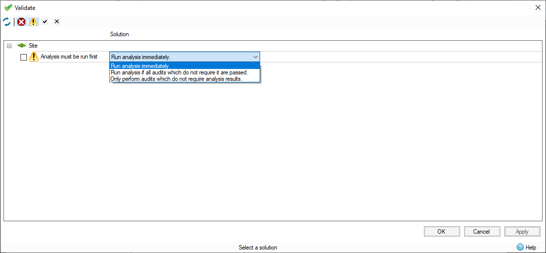

Before the audit report is generated, validation is run on the selected audits and phases, to ensure that the audit report can be generated. This validation will include logical validation of the audits (e.g. is the maximum value larger than the minimum value?), and simple validation of the site (e.g. are there any connections to audit?).

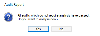

Some audits will require analysis results to be considered valid. When this is the case, a warning will be displayed in the validation form.
This warning appears once, and offers the following solutions:
If no solution is selected when OK is clicked, if no other validation errors exist, the audits that do not require results are run. Whether all of these pass, or some fail, is reported with the option to run analysis and generate a full report, or to not run analysis and generate a report containing only audits that do not require analysis. Any phases selected for auditing that are currently not included in analysis will be set to be included.
After performing the audit, the Review Failures
button can be selected to quickly isolate the causes of the failing audit. In most cases, selecting an error here will take you to the appropriate location to resolve the error. In some cases solutions which can be instantly applied are provided.
