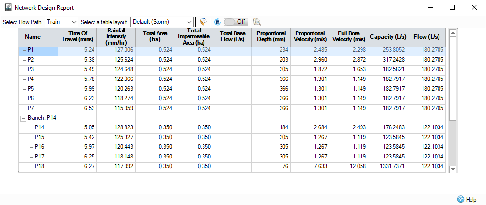

Default
 A layout similar to the Network Design Results of previous versions.
Name – Name of the connection as shown on the plan view.
Time of Travel – The Travel Time is calculated as the Min. Time of Entry from the Network Design + The Travel Time through the Upstream connections. The time of travel for a given connection is calculated using the velocity of flow under full-bore conditions and the length of the connection.
Rainfall Intensity – The Rainfall Intensity is determined from the IDF data, specified on the Network Design, based on the Travel Time for the given connection. The Rainfall Intensity is then used in the selected Calculation Method to determine the flow used for Auto-Sizing the pipes/channels.
Total Area – The total area (not factored by Runoff Coefficient) is used rather than the contributing area. This does not include the upstream contributing areas.
Total Impermeable Area – Total impermeable area from connected Inflows. This is factored by the Percentage Impervious specified per area before being summed.
Total Base Flow – Total base flow including all base flows from the upstream connections.
Proportional Depth – The Proportional Depth is the actual depth of water in the pipe for the calculated flow.
Proportional Velocity – The Proportional Velocity is the velocity of water in the pipeline (i.e. at the Proportional Depth) corresponding to the calculated flow.
Capacity Limited to XX% – The pipe capacity at the limited pipe conditions as specified in the Network DesignCriteria. The column is visible if Limit Pipe Full Conditions is ticked in the Network Design Criteria.
Full-Bore Velocity – The Full-Bore Velocity is calculated using either the Manning Formula  or the Colebrook-White Formula and is based on full-bore conditions.
Capacity – The Pipe Capacity is calculated using either the Manning's n or Colebrook-White equation and is based on full-bore conditions.
Flow – The flow is determined based on the calculation method selected in the Network Design :
Rational Method : Flow = Rainfall Intensity x Total Area + Total Base Flow
(UK) Modified Rational Method: Flow = Rainfall Intensity x Total Area * Cr(1.3) + Total Base Flow
Methode de Caquot – Flow is calculated by a series of formula used by the Methode de Caquot.
The Default layout for foul phases has some differences. See Foul Phases.

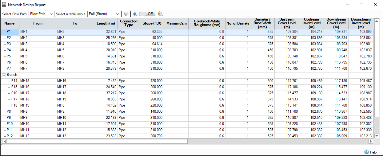

Full
A more complete set of data, including many of the details entered during Network Design.
Hidden Columns
From – The label of the item at the upstream end of the connection.
To – The label of the item at the downstream end of the connection.
Length – Length of the connection. If in red – the length was defined by the user. Otherwise, it was calculated using the Connections coordinates from the plan view.
Connection Type – The types of connections are:
Slope – Longitudinal slope of the connection. This is calculated based on the fall, between the upstream & downstream invert levels, along the length of the connection. Entering a value for the slope will therefore adjust the downstream invert level.
Manning's n – Manning's coefficient for the connection, which will be used in velocity and flow/capacity calculations.
Colebrook-White Roughness – Colebrook-White roughness for the connection, which will be used in velocity and flow/capacity calculations.
No. of Barrels – Number of barrels/channels laid in parallel.
Diameter/Base – Diameter of the connection of a Pipe, or base width of a rectangular or trapezoidal channel.
Height – Height of a rectangular, trapezoidal or triangular channel.
Corner Splay – Introduced into a Box Culvert for pipe-strengthening purposes. This value cannot be greater than half the current width or half the current height. The default value is 0 and will not be automatically adjusted.
Side Slope – Slope of the sides of a trapezoidal or triangular channel.
Upstream Cover Level – The cover/exceedance level at the upstream end of the connection. Levels may be set automatically if sufficient data exists. See individual connection type pages for more details.
Upstream Invert Level – The invert level at the upstream end of the connection. Levels may be set automatically if sufficient data exists. See individual connection type pages for more details.
Downstream Cover Level – The cover/exceedance level at the downstream end of the connection. Levels may be set automatically if sufficient data exists. See individual connection type pages for more details.
Downstream Invert Level – The invert level at the downstream end of the connection. Levels may be set automatically if sufficient data exists. See individual connection type pages for more details.
Cover Depth – For closed connections, the smaller of the upstream and downstream cover levels.
Total Area – The total area (not factored by Runoff Coefficient) is used rather than the contributing area. This does NOT include the upstream contributing areas.
Total Contributing Area – Total contributing area from connected Inflows . This is factored by the Runoff Coefficient and Percentage Impervious specified per area before being summed. This includes all the upstream contributing areas.
Volumetric Runoff Coefficient – The average (per-unit area) preliminary sizing volumetric runoff coefficient of all inflows to the connection.
Local Time of Concentration – The time required for water to travel from the hydraulically most distant point of the drainage area to the inlet at the upstream end of the storm drain run under consideration.
Time of Travel – The Travel Time is calculated as the Min. Time of Entry from the Network Design criteria + The Travel Time through the Upstream connections. The time of travel for a given connection is calculated using the velocity of flow under full-bore conditions and the length of the connection.
Rainfall Intensity – The Rainfall Intensity is determined from the IDF data, specified on the Network Design criteria, based on the Travel Time for the given connection. The Rainfall Intensity is then used in the selected Calculation Method to determine the Flow used for Auto-Sizing the pipes/channels.
Capacity Limited to XX% – The pipe capacity at the limited pipe conditions as specified in the Network Design Criteria. The column is visible if Limit Pipe Full Conditions is ticked in the Network Design Criteria.
Flow – The flow is determined based on the calculation method selected in the Network Design  criteria:
Methode de Caquot – Flow is calculated by a series of formulas used by the Methode de Caquot.
The Full layout for foul phases has some differences. See Foul Phases.

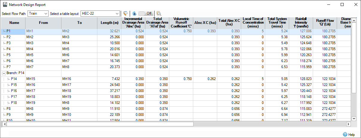

HEC-22
 The layout used by Hydraulic Engineering Circular No. 22 for preliminary storm drain computation.
Incremental Drainage Area 'AInc' – Individual area from connected Inflows.
Total Drainage Area 'ATot' – Total area from connected Inflows. This includes all the upstream contributing areas.
Volumetric Runoff Coefficient 'C' – The runoff coefficient for the drainage area tributary to the inlet at the upstream end of the connection.
AInc X C – The incremental drainage area multiplied by the runoff coefficient for the drainage area tributary to the inlet at the upstream end of the connection.
Total AInc X C – Total contributing area from connected Inflows. This is factored by the Runoff Coefficient specified per area before being summed. This includes all the upstream contributing areas.
Total System Travel Time – The Travel Time is calculated as the Min. Time of Entry from the Network Design criteria + The Travel Time through the Upstream connections. The time of travel for a given connection is calculated using the Velocity of flow under full-bore conditions and the length of the connection.
Rainfall Intensity 'I' – The Rainfall Intensity is determined from the IDF data, specified on the Network Design criteria, based on the Travel Time for the given connection. The Rainfall Intensity is then used in the selected Calculation Method to determine the Flow used for Auto-Sizing the pipes/channels.
Runoff Flow 'Q' – The flow is determined based on the calculation method selected in the Network Design criteria:
Diameter/Base Width – Diameter of the connection of a pipe, or base width of a rectangular or trapezoidal channel.
Full Flow – The Full Flow is calculated using either the Manning's n or Colebrook-White equation and is based on full-bore conditions.
Design Velocity – The Design Velocity is the velocity of water in the pipeline (i.e. at the Proportional Depth) corresponding to the calculated flow.
Section Time – The travel time in the pipe section. Calculated by dividing length by the design velocity.
Soffit Drop – Calculated by subtracting the downstream invert level of the previous connection from the upstream invert level of the current connection.
Slope – Longitudinal slope of the connection. This is calculated based on the fall, between the upstream and downstream invert levels, along the length of the connection. Entering a value for the slope will therefore adjust the downstream invert level.

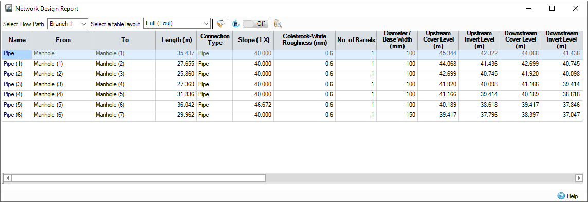

Foul Phases
For foul phases, the default and full layouts differ to the storm layouts.
The following columns are not applicable: Time of Travel, Rainfall Intensity, Total Contributing Area and Total Impermeable Area.
The report contains the following additional columns.
Total Discharge Units – The total of all discharge units. See Foul.
Total Dwellings – The total number of dwellings. See Foul.
Proportional Velocity at 1/3 Flow – The proportional velocity achieved by a connection with only 1/3 of the calculated flow. The column is visible if Check Velocity is ticked in the Network Design Criteria and 1/3 Proportional Velocity or (UK) 1/3 Proportional Velocity is selected.
