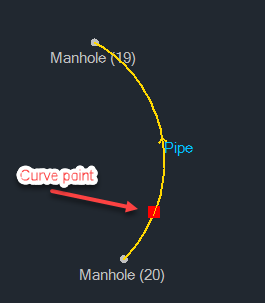

- Click the first junction, click in between the two junctions to create the curve point, and then click on the second junction.
Modifying the location of a curve point
- Click the curve point that you want to modify.
- Drag the curve point to the desired location.

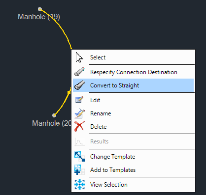

Modifying a curved connection to make it a straight connection
- Right-click a curved connection on the Plan.
Select Convert to Straight.
You can modify a straight connection and make it into a curved connection by following the same steps, and then selecting Convert to Curved.
