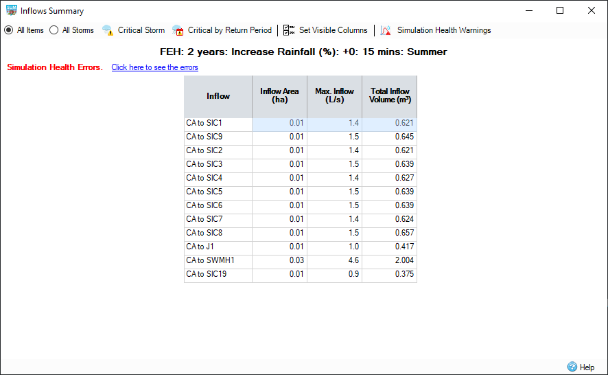

Inflows Summary
The Inflow Summary Results shows a summary of how each Inflow in the current phase performed.
Filtering the Results
For phases containing only Baseflow or Input Hydrographs, filtering will not be available.
When the All Items radio button is selected, the summary shows the maximum flow rates entering and leaving together with details of the volumes for each of the Inflow in the Phase for the current storm/event as highlighted on the Storm Selector on the Status Bar. The Select Filter drop-down filters the results to show All Items or a selected Flow Paths.
When the All Storms radio button is selected, the summary shows the maximum flow rates in and out of the Inflows selected in the Select Item drop-down, together with details of the volumes for each of the storms run. This is of most interest when Rainfall with multiple storms is selected on the Analysis Criteria.

Spreadsheet Preferences
Fields can be turned on or off using the Spreadsheet Preferences form, which is accessed from the toolbar at the top of the form. The full set of columns available are shown and can be turned on or off using the tick boxes. These settings will be remembered between sessions.
Simulation Health
If the results of the analysis are showing issues for the current storm, or one of the storms if showing critical/all storms, a message will be shown at the top of the form. More information can be found in the Simulation Health section.
Additionally, the simulation health warning hyperlink can be clicked to display the Simulation Health Warnings for the current phase.
Results
Inflow – The name of the Inflow item.
Inflow Area – The area of the Inflow for the selected or displayed rainfall event, left blank for Hydrographs and Base Flows.
Max Inflow – The maximum inflow reached for the selected or displayed rainfall event.
Total Inflow Volume – The total volume generated by the inflow for the selected or displayed rainfall event.
