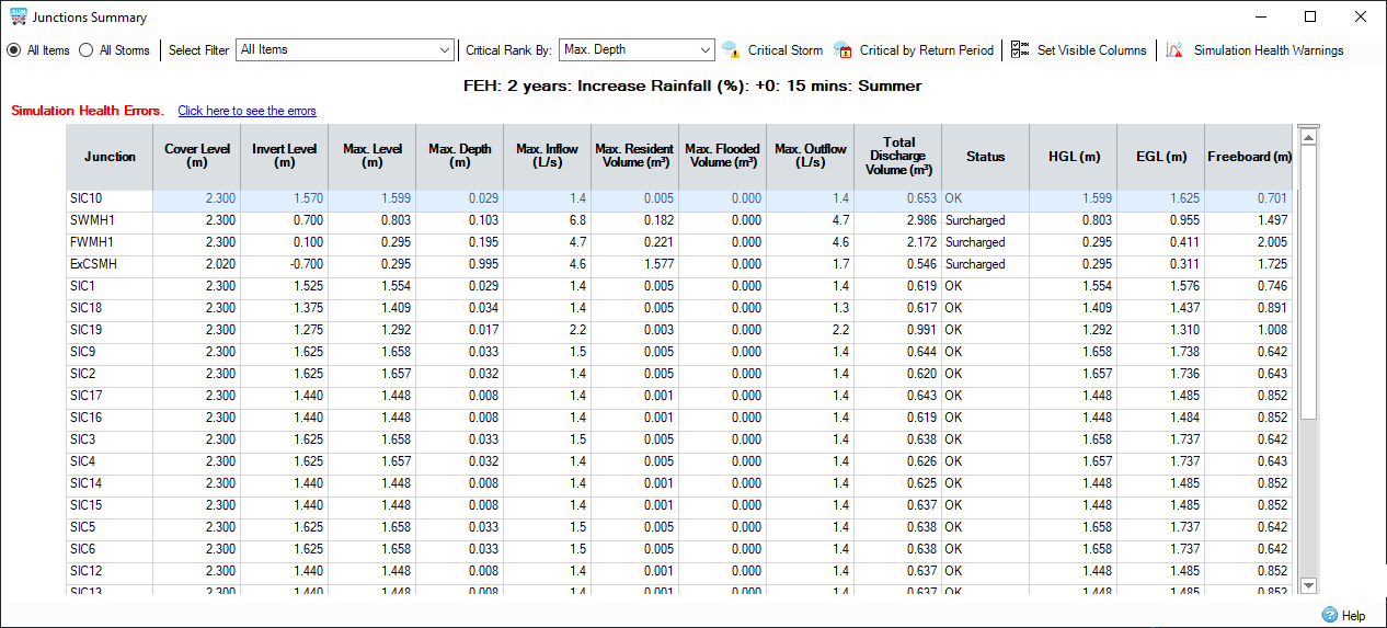

The Junctions Summary Results shows a summary of how each Junctions in the current phase performed.
For phases containing only Baseflow or Input Hydrographs, filtering will not be available.
When the All Items radio button is selected, the summary shows the maximum flow rates entering and leaving together with details of the volumes for each of the Junctions in the Phase for the current storm/event as highlighted on the Storm Selector on the Status Bar. The Select Filter dropdown filters the results to show All Items or a selected Flow Paths.
When the All Storms radio button is selected, the summary shows the maximum flow rates in and out of the Junctions selected in the Select Item drop-down, together with details of the volumes for each of the storms run. This is of most interest when Rainfall with multiple storms is selected on the Analysis Criteria.
For phases containing only Baseflow or Input Hydrographs, critical rank by option will not be available.
The Critical Rank By dropdown allows the selection of a specific property in the summary that will determine the critical storm (see below).

Fields can be turned on or off using the Spreadsheet Preferences form, which is accessed from the toolbar at the top of the form. The full set of columns available are shown and can be turned on or off using the tick boxes. These settings will be remembered between sessions.
If the results of the analysis are showing issues for the current storm, or one of the storms if showing critical/all storms, a message will be shown at the top of the form. More information can be found in the Simulation Health section.
Additionally, the simulation health warning hyperlink can be clicked to display the Simulation Health Warnings for the current phase.
Cover Level – The cover level of the Manhole is shown for reference.
Invert Level – The invert level of the Junction is shown for reference. Note: if abstract connections (No Delay, Lagged Flow) are connected to a simple junction then this will be left blank).
Max Level – The maximum water level (above datum) reached in the item for the selected or displayed rainfall event. Note: if abstract connections (No Delay, Lagged Flow) are connected to a simple junction then this will be left blank).
Max Depth – The maximum water depth (above invert level) reached in the item for the selected or displayed rainfall event. Note: if abstract connections (No Delay, Lagged Flow) are connected to a simple junction then this will be left blank).
Max Inflow – The maximum inflow (totalling all inlets) reaching the item for the selected or displayed rainfall event. This does not include Bypassed inflow.
Max Resident Volume – The maximum volume in the item for the selected or displayed rainfall event including flooded volume. Note: if abstract connections (No Delay, Lagged Flow) are connected to a simple junction then this will be left blank).
Max Flooded Volume – The maximum volume above the exceedance level or cover level in the item for the selected or displayed rainfall event. Note: only Manholes can flood.
Max Outflow – The maximum outflow (totalling all outlets) leaving the item for the selected or displayed rainfall event.
Total Discharge Volume – The total volume leaving the item, through all outlets for the selected or displayed rainfall event.
All numeric columns are shown to a default number of decimal places based on the unit. If you want to see more or less decimal places, you can select Increment Decimal or Decrement Decimal from the right-click menu. This setting will not be saved between sessions.
Status – Based on the level in the Junction, the following status will be shown:
By definition, the water level in a sealed manhole will never exceed the cover. Therefore the status of a sealed manhole is only ever OK or Surcharged. In any case where it was required to cap the water level, i.e. an unsealed manhole would have flooded. The status is marked with an asterisk, i.e. OK* or Surcharged*.
