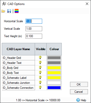

CAD Options
The CAD Options form is used to set up the CAD Export options. The colours can be modified for each layer. The layers can be turned off using the lightbulb icons. Scaling factors can be selected for both horizontal and vertical axes, and a text height can be applied to ensure all text is a suitable height.
The settings can be saved and re-loaded using the toolbar icons. The toolbar also contains a Reset button to revert all colours and settings to their default values.
