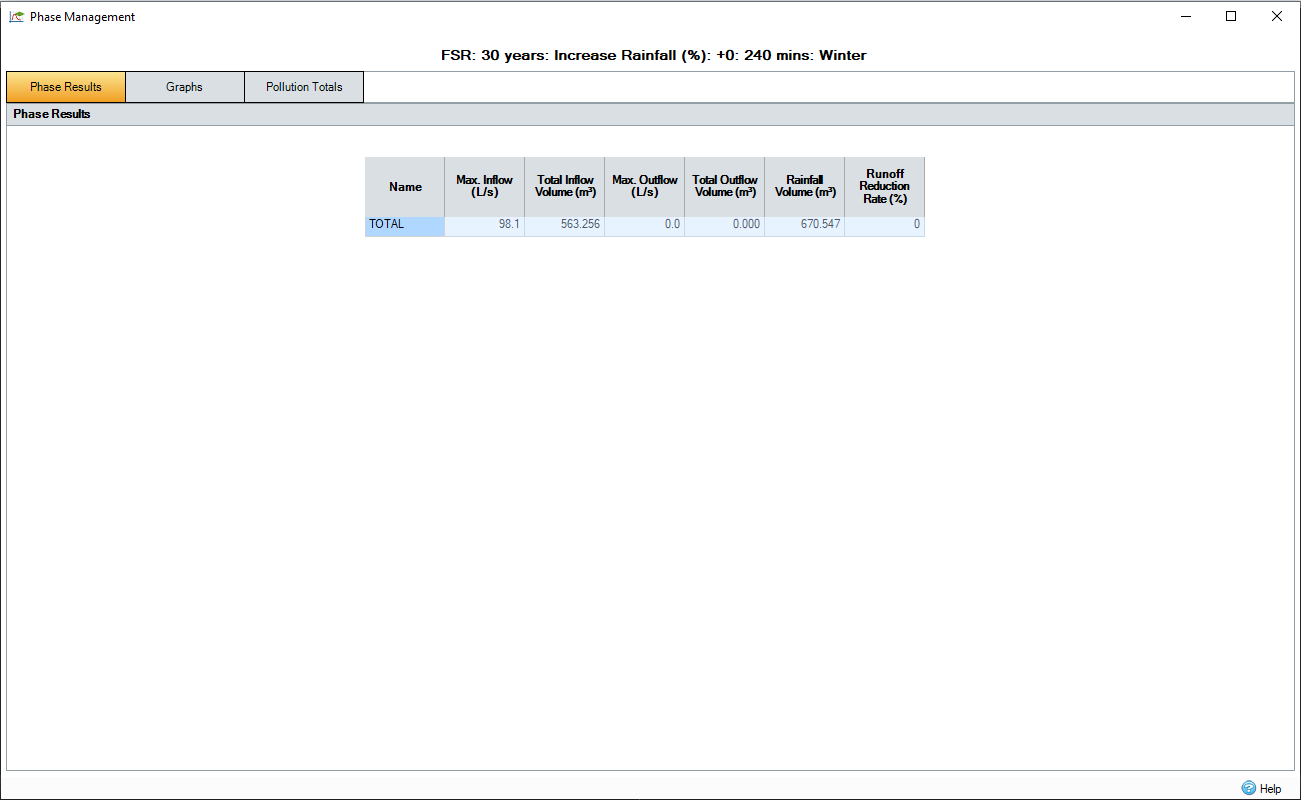

Phase Results
The table shows the overall inflow and outflow values for the phase, together with details of the Runoff Reduction Rate. The final row shows total system results including Volume In, Volume Out, Max Inflow and Max Outflow for the current phase
Inflows
The peak inflow rate, as well as the total inflow value, is calculated from each of the inflows to the system.
Outflows
Each of the Outfalls in the system is shown on its own row to give a breakdown of the peak outflow rate and total discharge volume.
Rainfall Volume
For phases containing only Baseflow or Input Hydrographs, rainfall volume will not be available.
This is the volume of water landing on the phase areas together with the total volume from any Input Hydrographs.
Rainfall Volume = Rainfall Depth * Total Area + Total inflow volume from Hydrographs
This shows the overall reduction in runoff volume when compared to the Rainfall Volume.
Runoff Reduction Rate = 1 - (Outflow Volume/Rainfall Volume)

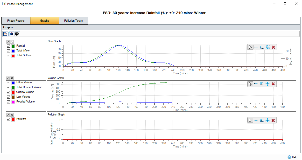

Graphs
Provides three graphs showing different aspects of the total system result, each of which can be turned on and off as required. For more information, see the Graph Tools and Results Graphs pages.
Flows – Shows the Inflows and Outflows into/from the Phase against time. For phases containing only Baseflow or Input Hydrographs, rainfall will not be available.
Volumes – Shows the Resident and Lost volume(s) in/from the Phase against time.
Pollution – Shows the Pollutant concentrations in the Phase against time.

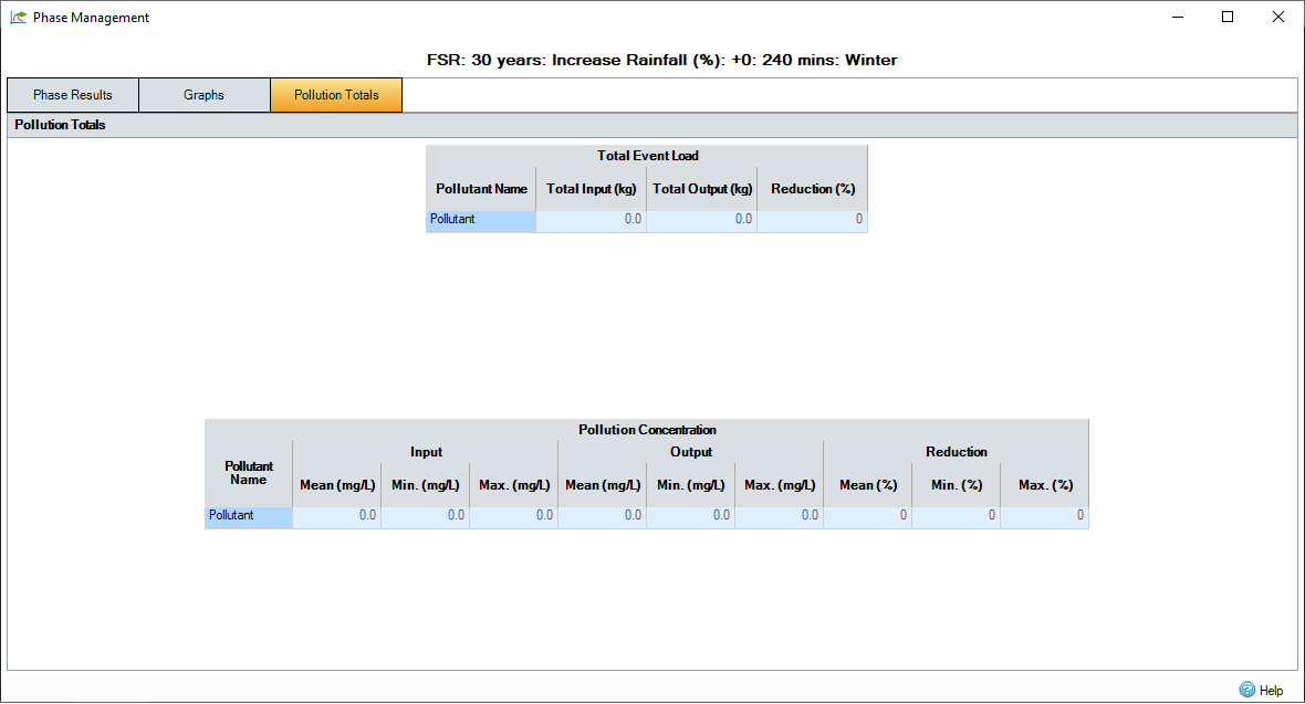

Pollution
Provides a breakdown of the Pollutant loads entering and leaving the total system, as well as details of the Concentrations. This tab is only available when there are pollutants on the site.
Total Event Load – Shows the total Input, Output and Reduction for each Pollutant
Pollutant Concentration – Shows the Mean average, Minimum and Maximum concentration for the Input and Output of each Pollutant. Also shows the Reduction in Mean average, Minimum and Maximum Pollutant Concentration.
