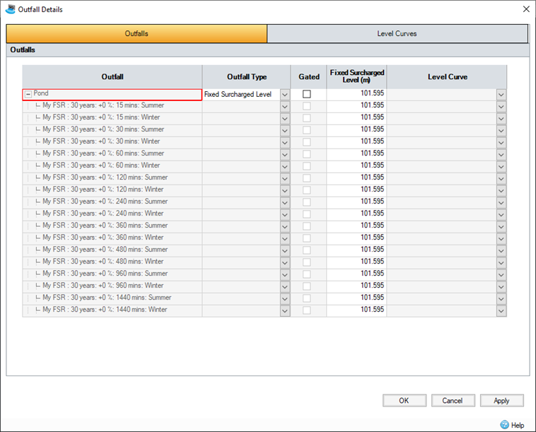

Outfalls Tab
This allows the outfalls to be viewed and the Type for each outfall to be specified.
Outlet Type
This is the type of outfall restriction that is in place:
Note: Where a Junction/Manhole does not have outlets, the water will pass straight through for discharge. Where a Fixed Surcharge Level is specified, the water will build up to this level before discharging.
Once the Outfall Type has been selected the actual value can be varied on a Storm-by-Storm basis as needed. This can be useful if the level will be dependent on the storm being analysed.
Gated
If an outfall is gated, then backwater flow is prevented.
Note: This is only available for Fixed Surcharge Elevation and Variable Surcharge Elevation.

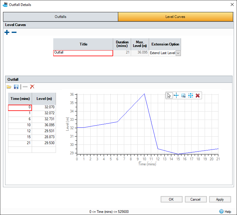

Level Curves Tab
This allows the set of Level Curves (Hydrographs) that are required to be specified and edited.
The (top) table provides a list of the Curves that are required to describe outfall restrictions for each outfall and/or storm.
This displays:
Name – The label given to the curve to aid identification.
Duration – The total length of the curve.
Max Level – The maximum level found in the curve.
Extension Option – Specify how the curve should be extended IF the analysis runtime exceeds the duration of the curve. The options are:
Add/Remove Curves
The + and - buttons are used to add and remove curves from the table as needed. It is possible to select multiple rows and delete them at once.
Note: If a curve is currently being referenced on the Outfalls tab this will be reset to '(none)' if the curve is deleted, which will prevent the analysis from running until a new curve is selected.
Editing the Curve
When a curve is highlighted on the top table, its details can be edited in the panel below. The values can be entered directly, pasted or loaded from file. The graph then shows a representation of the visual data that has been entered.
Load – Allows data to be loaded from: Level Hydrograph Files (IDHYLX), CSV, TXT or Excel formats using the Universal Importer.
Save – Allows the hydrograph to be saved to an Level Hydrograph File (IDHYLX) so it can be reused on another design.
Delete Row – The currently selected row(s) are removed.
Clear – The whole table is cleared.

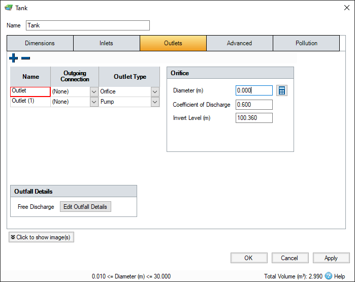

Accessing the form
The Outfall Details can be accessed from the Tree View or the Analysis Ribbon.
Alternatively, when a Junction or SWC is an Outfall location an option that links to the Outfall Details form is shown on the Outlets tab.
