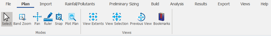

Plan Ribbon
Navigate and manipulate the 2D plan view (in the middle of your screen). For more information about this topic, go to Plan Ribbon.

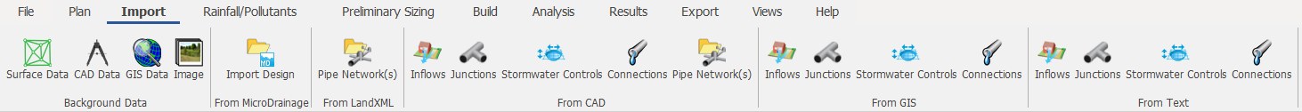

Import Ribbon
Import and create data that describe your site. For more information about this topic, go to Import Ribbon.

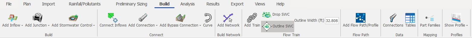

Build Ribbon
Create a new design using individual items or as a treatment train – this is the way we generally refer to the sustainable drainage network that is to be designed using InfoDrainage. For more information about this topic, go to Build Ribbon.

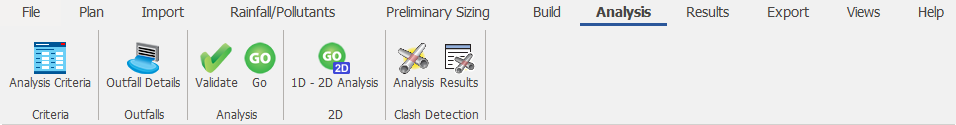

Analysis Ribbon
Validate the design of the treatment train, and analyse rainfall and pollutant flow through the treatment train. For more information about this topic, go to Analysis Ribbon.

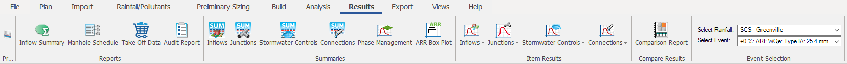

Results Ribbon
Tabular and graphical views of the analysis results. For more information about this topic, go to Results Ribbon.

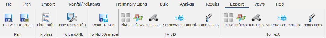

Export Ribbon
Export data from your site to a range of formats. For more information about this topic, go to Export Ribbon.

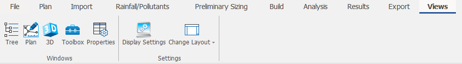

Views Ribbon
The Views Ribbon provides options to open or select different windows in InfoDrainage, as well as an easy way to Change Layout of the windows and configure the Display Settings.

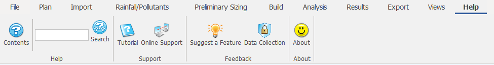

Help Ribbon
InfoDrainage works best with online help – as long as you are connected to the internet. If not, offline help is available. For more information about this topic, go to Help Ribbon.
