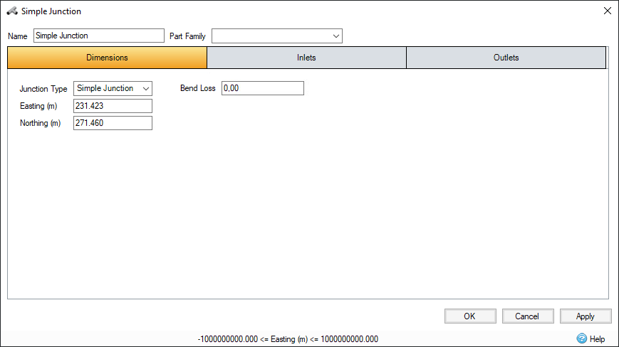

Name – Displays the name of the manhole.
Part Family – Select the part family associated with this manhole. For more information, see Part Families.
Dimensions
Junction Type – Select either Simple Junction or Manhole from the drop-down list.
Easting – The easting coordinate at the centre of the icon on Plan.
Northing – The northing coordinate at the centre of the icon on Plan.
Bend Loss – The loss coefficient associated with energy losses that occur when flow enters a junction and then exits through an outgoing connection at a different angle. For more information, see Analysis of Junctions and Connections.
Refer to the Inlets and Outlets pages for more details on these tabs.
